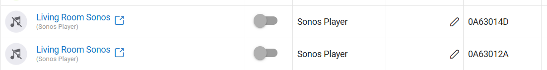

Then I attempted to add these speakers to the Hubitat Sonos Integration. Instead of adding the Living Room pair, it added two separate Living Room devices (again):
The IP addresses assigned by the Sonos Integration do not match what they actually are in my network. Based on the DNI values the IP addresses do not match anything on my network. Which explains the "No route to host" errors:

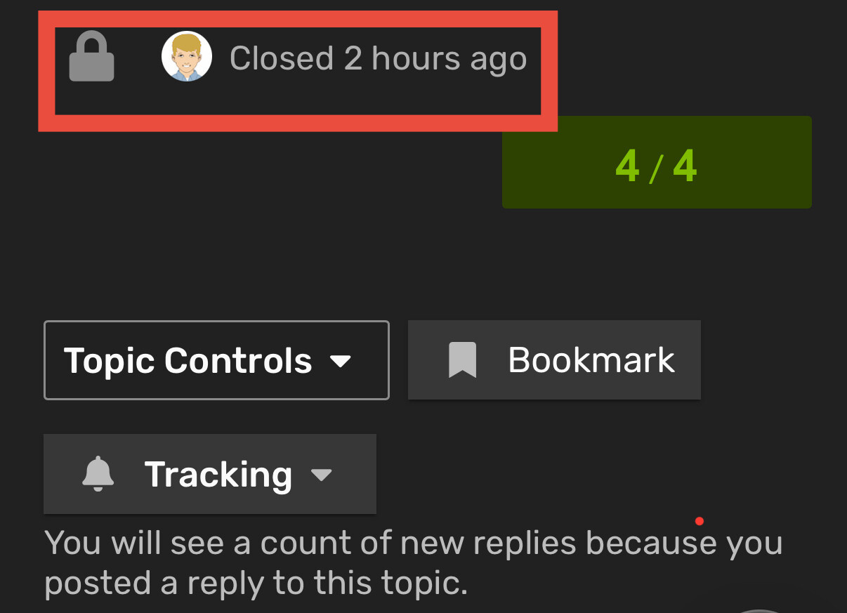

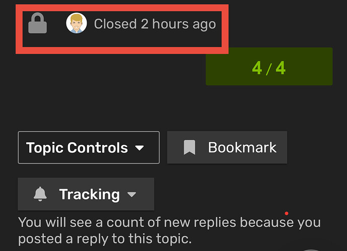

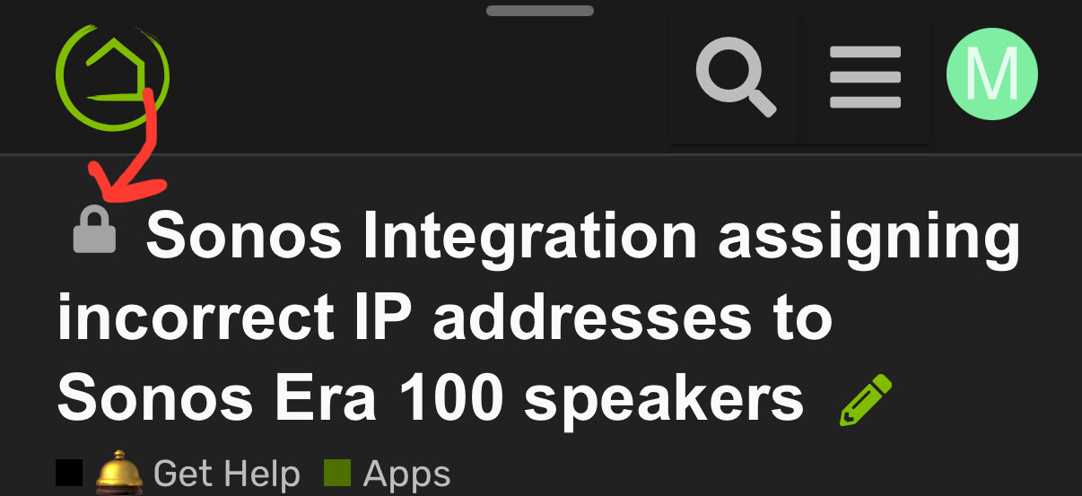

And for future reference, there are clear signs when a topic has been closed. See for example,
and
But sometimes posts just don’t get a reply for a few days.
In that case, you can simply create another post in your own thread (also objective evidence that a thread hasn’t been closed, btw) and “bump” it back to the top of the “latest topics” list and perhaps get more attention that way.
