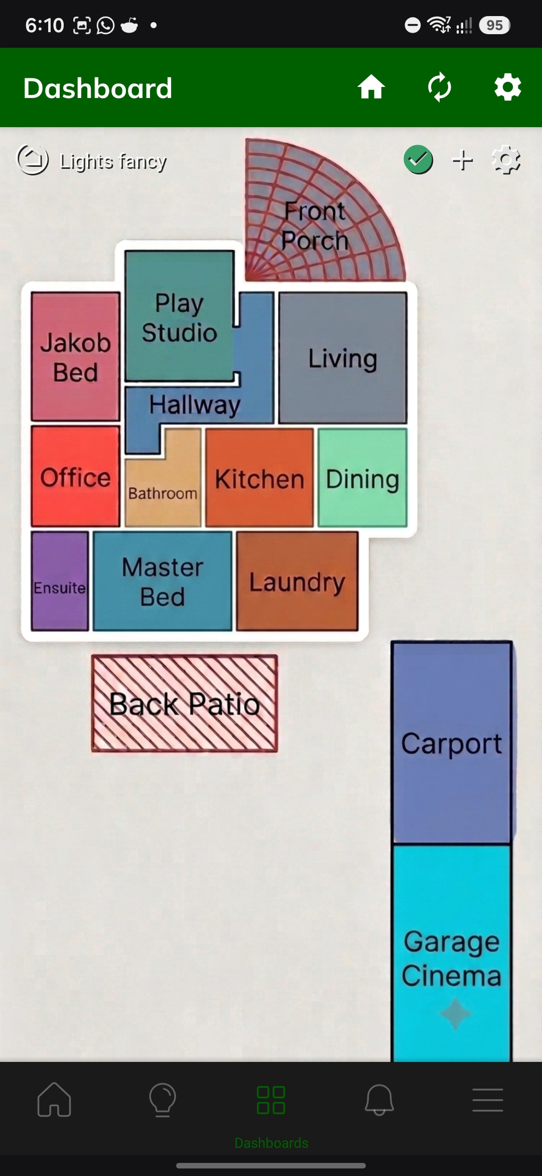

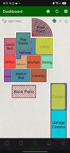

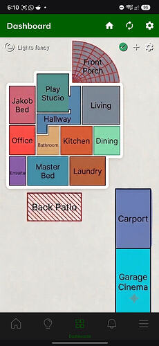

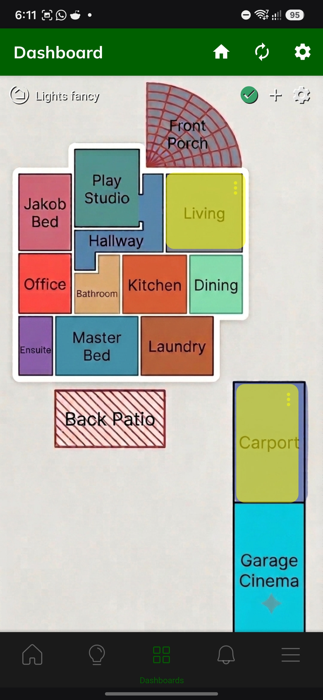

I've now tried to add a background of my house layout. Overlaying buttons for lights that are transparent when off, and semi transparent and yellow when on. Used some CSS script to hide labels and icons. I increase the grid size to the maximum before it started showing scroll bars. The tiles can't be made to fit perfectly because of thenlikitnin grid size.
