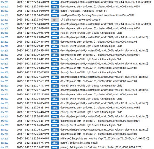

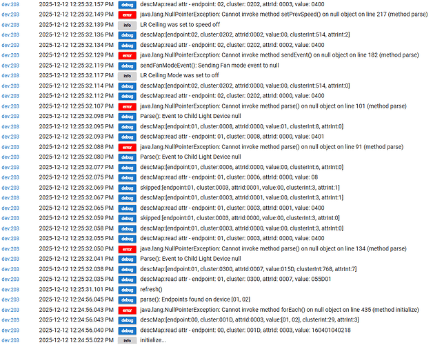

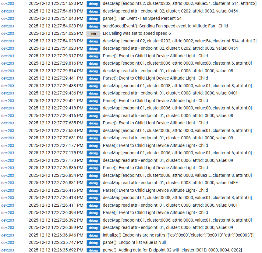

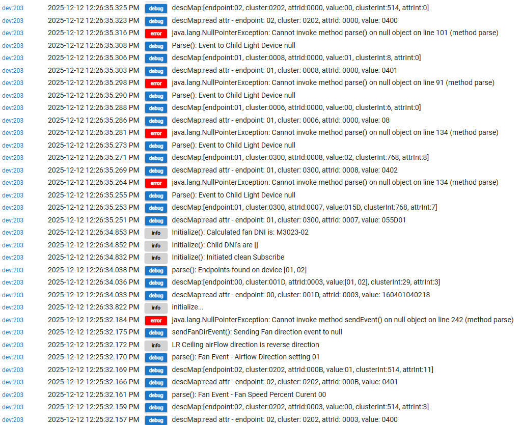

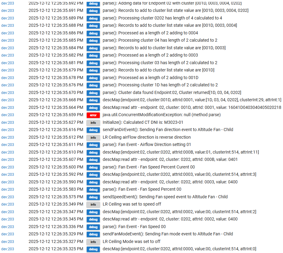

seems to be working. I'll copy logs here, but I think I may just have moved too fast or it took a couple of commands for it to create the child devices.
from there on it started working. sorry for the data overload

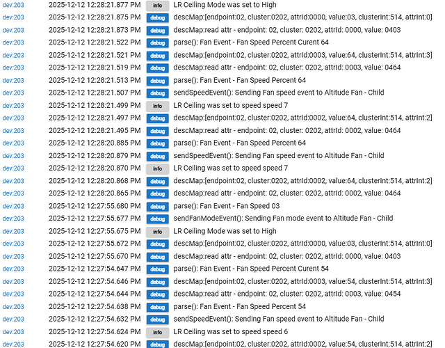

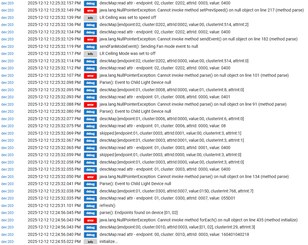

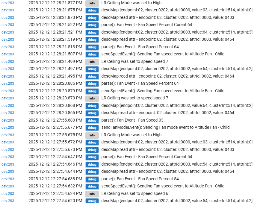

Were you able to look at the third endpoint. I tried adding it to the driver. Saved it as a separate driver and then used an additional if statement to parse that device. However, I didn't quite get it. I let it go for a bit and now that I'm revisiting, I'm going in circles. when adding the device, it makes a light and fan child. I delete those (at least the fan), change the driver to the altered driver, initialize, and it creates all three child devices. The light (endpoint 01) works fine. Endpoint 02 responds to commands, but will not update without sending a refresh command for some reason. Somehow in this process, I seem to have bricked the fan (now endpoint 03). It doesn't respond at all. It shows the following error when I do get something.
Nevermind, I finally messed with it enough until I was able to fifure it out. Main thing was I had to change the subscriptions I believe. For some reason, it didnt like the initial value of 1 in the previous speed. Once i was able to get that changed, the dan started working. Somehow during the process i reverted back to the original parent for the 2 children instead of the 3 children and that had me confused for a bit.
