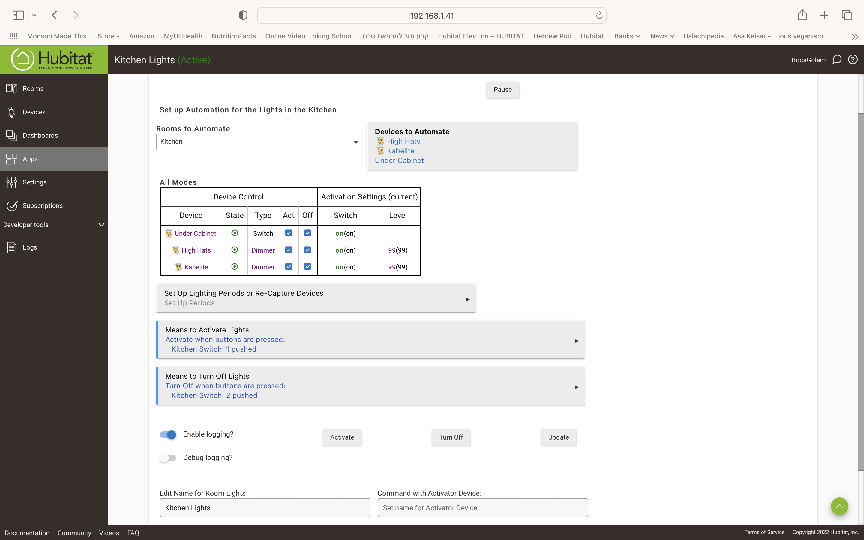

Is there a way to always get the Hubitat to send the commands on button press or is something else going on here.
We’ll need some more details.
Please start by posting some screenshots that show how you configured an automation with Hubitat to control your lights with your Zooz button controller.

I would suggest setting these two options. First one will make it activate even if already activated. Second one will help it decide when it should be "inactive" (a state of the RL not turn the lights off).
