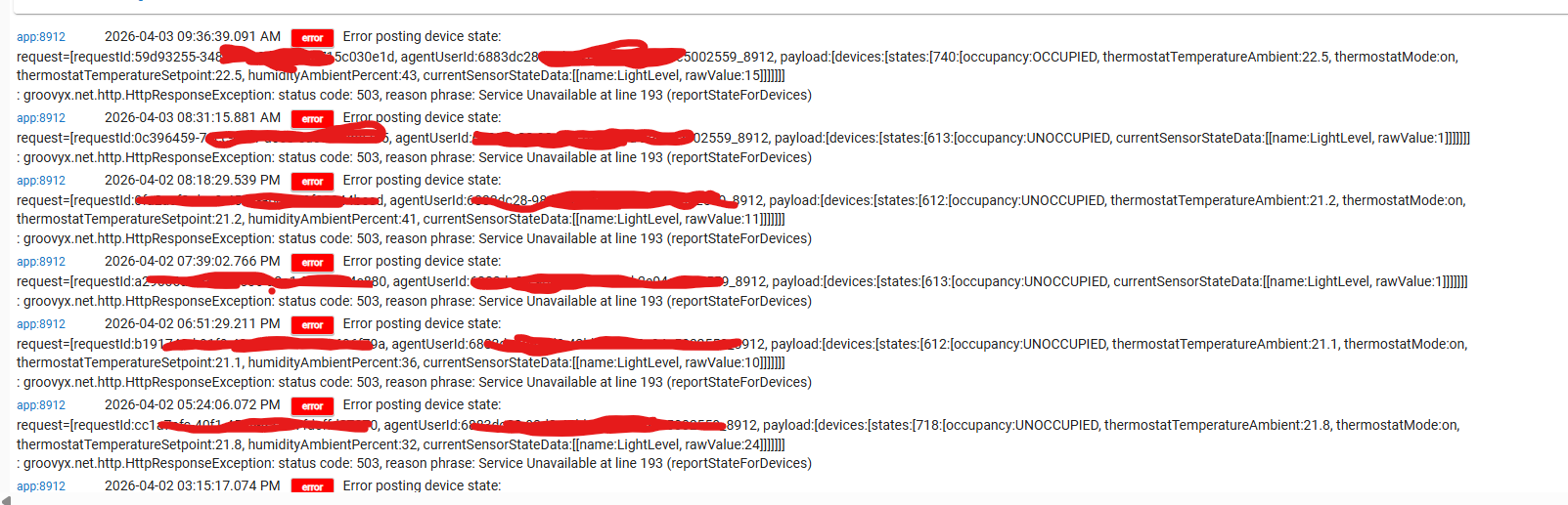

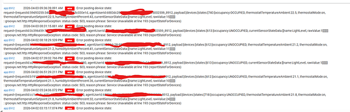

is anyone else getting lots of errors recently?
Yep, I've been seeing the same for about a month now.
Interesting, I haven't seen anything like that myself. Is it consistent, or does it only happen intermittently?
Seems to happen every day

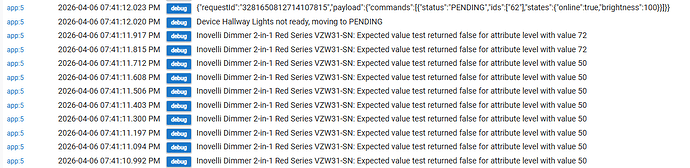

Another question. Why do I get test returned false:
That message just means that the app is waiting for the device to reach the desired state before reporting to Google that the action was successful. I assume you have a fade time on that dimmer so it takes a few seconds to reach full brightness.
