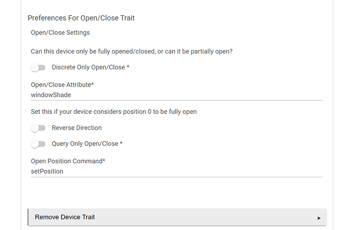

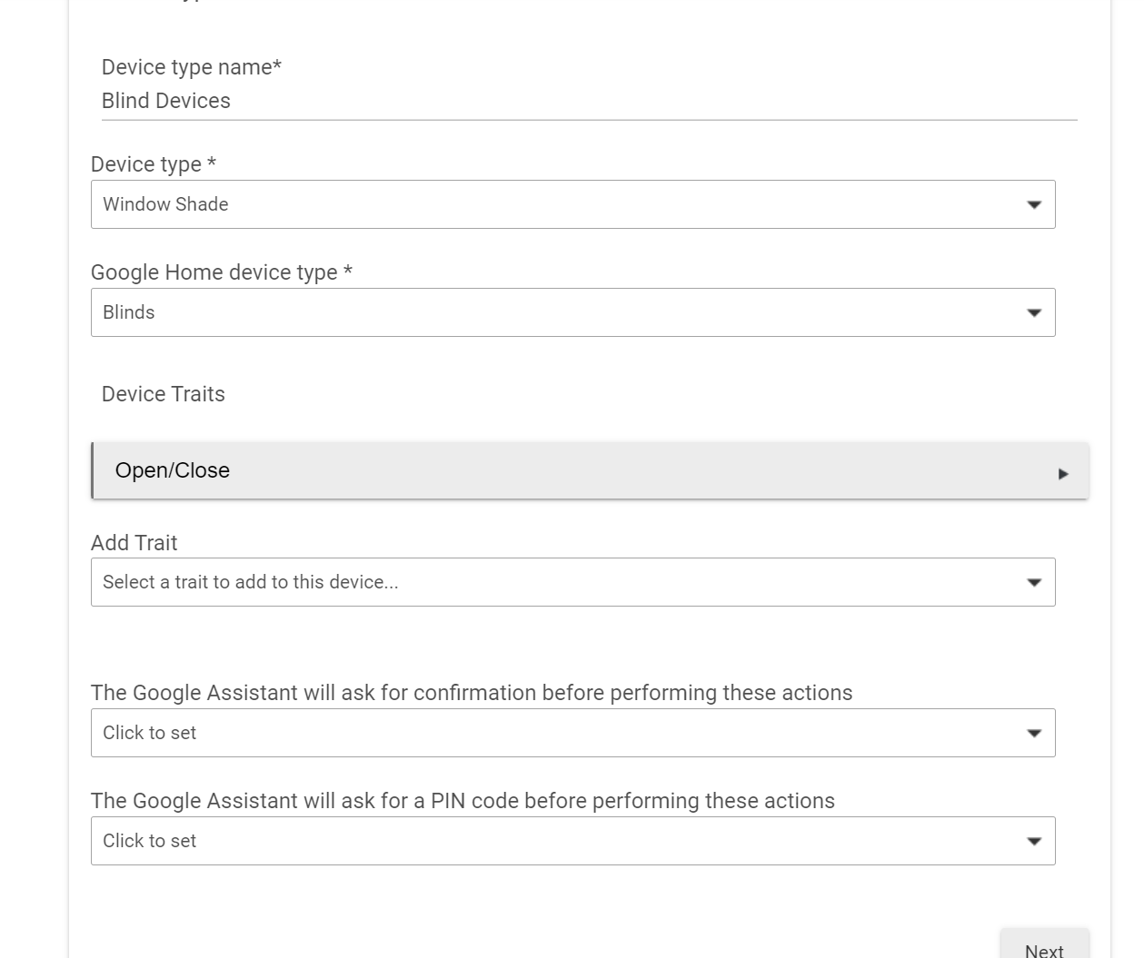

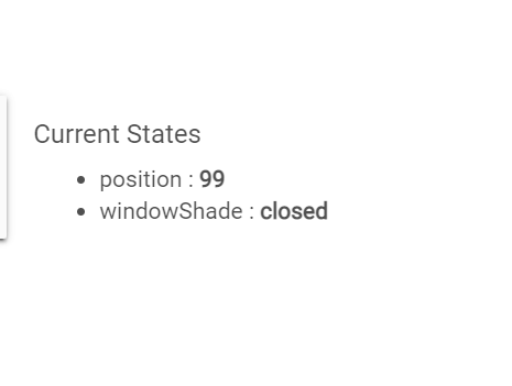

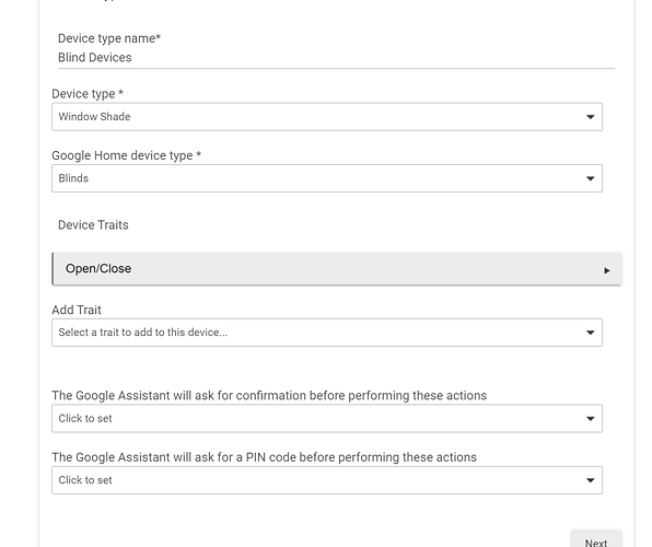

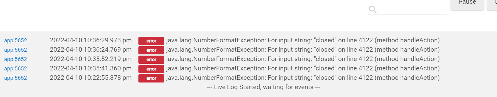

@mbudnek getting this error, not changed anything for a year +
private hubitatPercentageToGoogle(percentage) { // Hubitat's driver capabilities for SwitchLevel (setLevel) and WindowBlind // (setPosition) are documented to use the range [0..100], but several // Z-Wave dimmer devices return values in the range [0..99]. // // Rather than try to guess which is which, assume nobody will set a // device to 99% and map that specific value to 100. // // Clamp the value to ensure it's in the range [0..100], then map 99 // to 100. def clamped = Math.max(0, Math.min(100, percentage as int)) return clamped == 99 ? 100 : clamped }
So I assume its my z-wave blinds which do not report 100 and only 99 as 100 is not a value in z-wave apparently.
Same...tons of my devices now show offline in the GH app, but seem to be controllable. I hadn't noticed as I was still able to use voice commands to turn things on/off, and just happened to look in the GH app on my phone today and found most of my devices showing "offiline." Google must have "fixed something."
Don't really care as long as I can still use voice commands, but wanted to add that I'm seeing this as well.
How do I migrate to a new Hub?
Hmm, strange, my blinds are still working just fine (better, in fact, since the app can now open/close them, which I don't think it could before the recent update).
That error seems to indicate that it's getting the string "closed" where it expects a numeric percentage. What do the current states for your blinds look like in Hubitat and how are your blinds' traits configured in the Google Home Community app?
Hmm, I've never tried to do that, and I'm not sure what Hubitat does for you. Once the Google Home Community app is set up and configured on your new hub, then you should be able to unlink your Google Action from Google Home, update the OAuth parameters and fulfilment URL to point the new hub, and then re-link with your Google Home app. That's just a guess though; Google can be a bit picky about things changing.
That makes sense. The "Open/Close Attribute" for a non-discrete Open/Close trait needs to be something that reports the percentage of the way that the device is open. position
is likely what you want rather than windowShade
. You'll also probably need to turn on the "Reverse Direction" toggle, since it looks like your device reports fully-closed as 99%, and Google assumes that 99% means fully-open.
