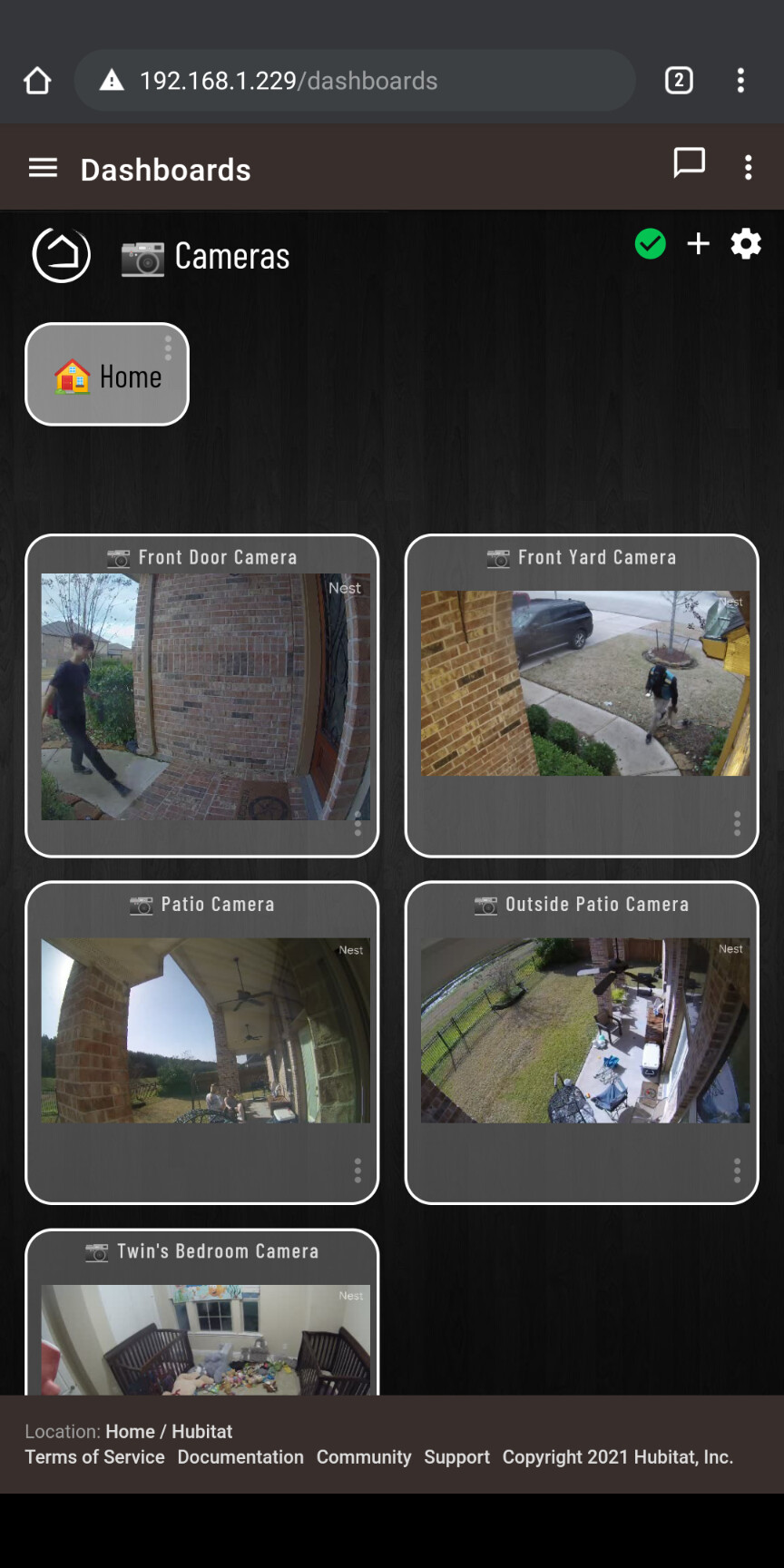

Can someone share how they have blue iris setup to stream the correct format? I have h.264 substream coming from the camera but cannot figure out the correct url to use. I think the camera shortname url I’m using defaults to the main stream and not the sub (according to VLC). /blueirisip/mjpg/shortname
Sadly, as far as I know, no. The Google Home app currently does not support fan speeds. The Nest Hub Max has touch controls for fan speed, but not the phone app. You could use the feedback form in the app to ask Google to implement it, but sadly that's about it. Which is annoying, since Alexa now has fan speed functionality by voice and in the app, and fan speed control was one of the primary reasons I made the switch in the first place.
The only one I could get to work is the m3u8:
http://<BI_SERVERURL>/stream/SDcam2.m3u8

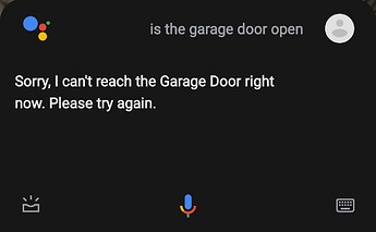

I was able to add GoControl Garage Door Controller using the Google Home Community app but I can't get Google Assistant to give me status on the door via voice command such as "is the garage door open?" it says it can't be reached.

The first step to debugging this issue is to turn on debug logging in the Hubitat app and watch the Hubitat logs when you query your garage door. You should see a line with intent=action.devices.QUERY in it followed by the response the app sent back to Google (possibly with some other stuff in between). Post those logs here and I should be able to help debug further.
