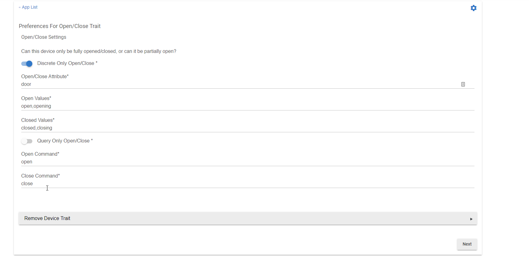

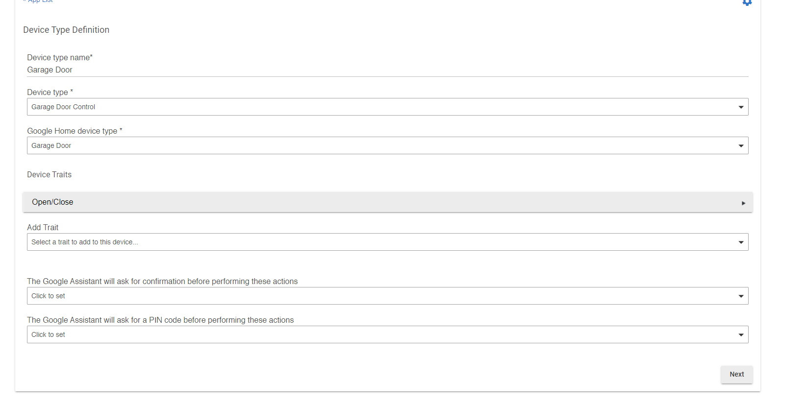

Apparently it is all about device name in Google. Renamed "Front door" to "Door" and garage door to "Gate" both work now.
And you are asking google home "Open the garage door" and it wasn't working before? It will never show up correctly in the Google Home app...that's a Google limitation currently for locks/doors. But it should allow you to use voice commands.
I cannot second this strongly enough. Now that temps are starting to rise, we might have our windows open. I read articles last year about people walking through neighborhoods yelling into windows "Alexa, open the garage door" or "Hey Google, unlock the front door" and seeing if they can get a response. Sometimes, just to screw with people. Now, these stories might just be urban legend, but that doesn't mean you shouldn't protect yourself. So, PLEASE, add a pin to barrier devices like locks and garage doors.
In fact, I would even support a pin being REQUIRED in the app for those two specific device types.
Voice command "Open the garage door is not working"... I would of set a PIN...
What is the response from Google Home when you do that? You have synced your device to Google Home and added it to a room when you tried that? Can you show the logs?
Google was saying, opening ... or closing... But actually was not doing anything. I renamed Garage Door, to "Gate" and it works as desired now. I guess there is nothing to be done.
Interesting. Do you have another device named "Front Door"? Alternatively, was your "Front Door" device previously using the official Google Home integration? I've seen "phantom" devices persist when switching between the two before.
"Official" Google integration does not allow to add device with Lock and Garage Control capabilities if I am not mistaken.
You can add them as a switch if the driver supports it. That's been the workaround for a lot of folks.
Yes. That is what I do too. Just was hoping that with new integration no work around will be needed :slight_smile:
No...you don't. LMAO. You just showed us your setup....and you don't use the switch capability anymore. You use the commands Open/Close, remember?

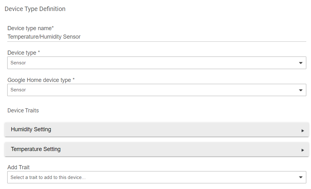

Hi,
so glad I found this project - really great work, tank you so much @mbudnek
One question. Should this work?
Both traits are set to query only. Google Assistant correctly reports the temperature, but not the humidity.
From the debug log:
app:12182020-04-09 12:43:57.409 debug[requestId:17577960441915319851, payload:[devices:[1290:[humidityAmbientPercent:41, thermostatTemperatureAmbient:22.48, thermostatMode:on, thermostatTemperatureSetpoint:22.48]]]]
Thanks,
Jan
Yeah, that should work. I have a few sensors set up exactly like that.
The Google Assistant is a bit picky about how you word requests for humidity though. "Hey Google, what's the humidity of {device}?" won't work, but "Hey Google, what's the humidity reading of {device}?" or "Hey Google, what's the humidity on {device}?" will. You can also say "Hey Google, what's the humidity in {room}?" and it will report the humidity reading of all humidity sensors in that room.
Thanks, got the reading by asking for the room humidity like you suggested. GA is really picky about a lot of things :wink:
