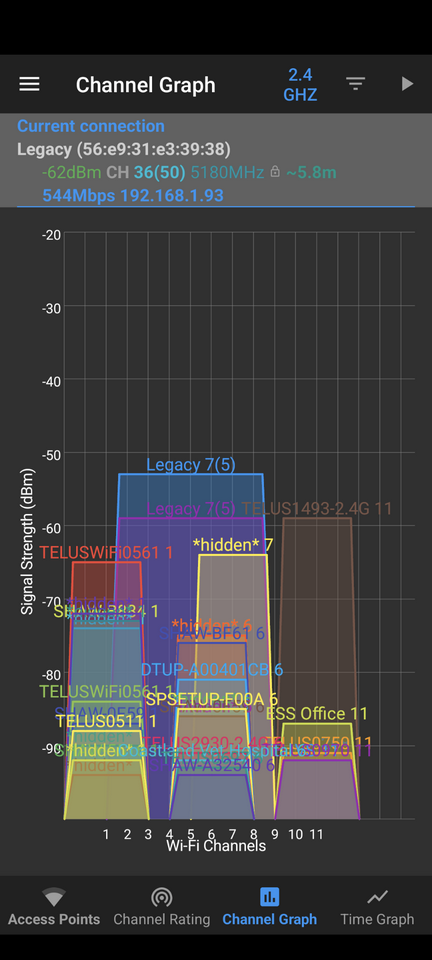

I'm still exploring changing channels. They neighbourhood is getting crowded in the 2.4 band and it looks like my new mesh access points have, an uncontrallable, wide bandwidth.
I can alter the 5 Ghz bandwidth but not the 2.4; it's automatic. :frowning:
You can see my mesh Legacy SSID takes up a lot of room. I has been in for 2 months though without any HE issues.

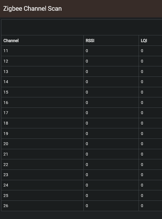

This is also strange. I rebooted the radio and now I have numbers.
One other person on my channel now - 20
That scan tool is iffy at best -- I wouldn't trust it very much.
My C7's zigbee was rock-solid but when I moved to C8, it became a mess... One of the two things that really helped get my zigbee mesh back working well was moving to Ch 25 (from 15 [my Hue is on 20]) and setting radio power to 4 -- that way, my repeaters are carrying almost all the water.

What channel is your 2.4Ghz wifi using? Deconflicting with any other ZB channel (e.g. Hue etc) is obviouly important, but staying clear of your 2.4 wifi is also key.
See above.
