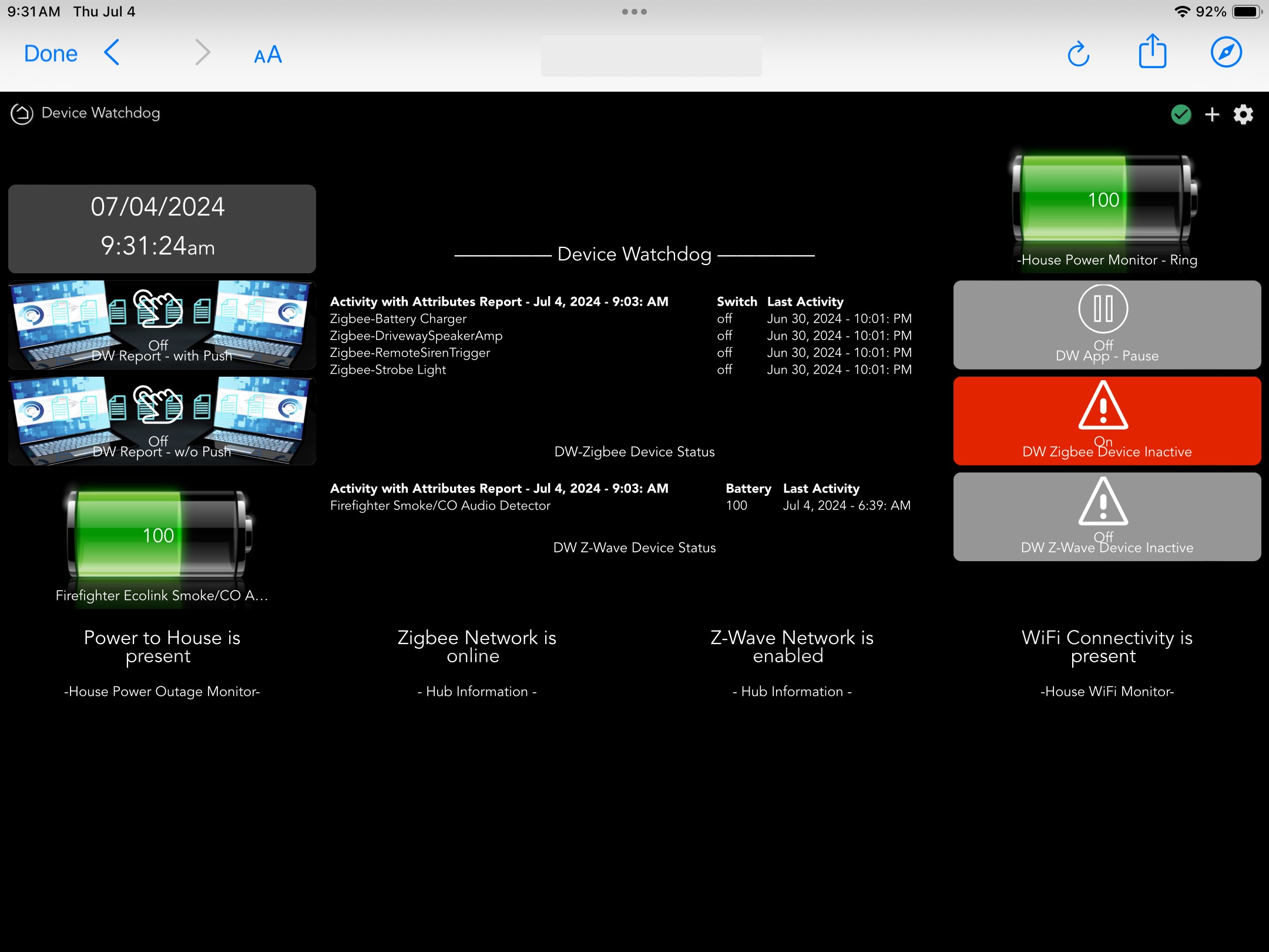

I just noticed that all my zigbee outlet plugs stopped working at the same time. I monitor my zigbee devices (I only have 4 of them) via the Device Monitor app (thanks @bptworld !). I noticed that they all went “offline” sometime on June 30th between 9pm and 10pm (they are monitored each hour and they did not “check in” at 10:01 pm on June 30th. . . See the photo of my dashboard).
That was also around the time I did a firmware update to 2.3.9.157 (I also had problems with my Tasmotized Treatlife wall switches not responding to Alexa at the same time but I was able to get the wall switches back working with a hard Hubitat reboot).

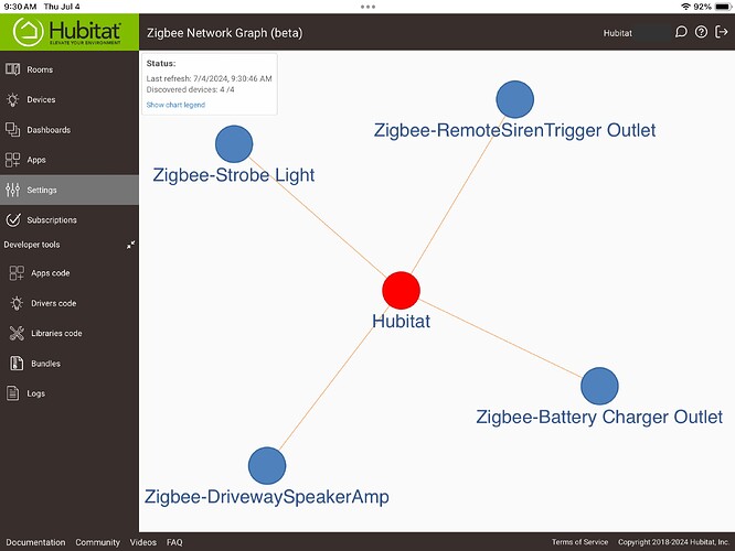

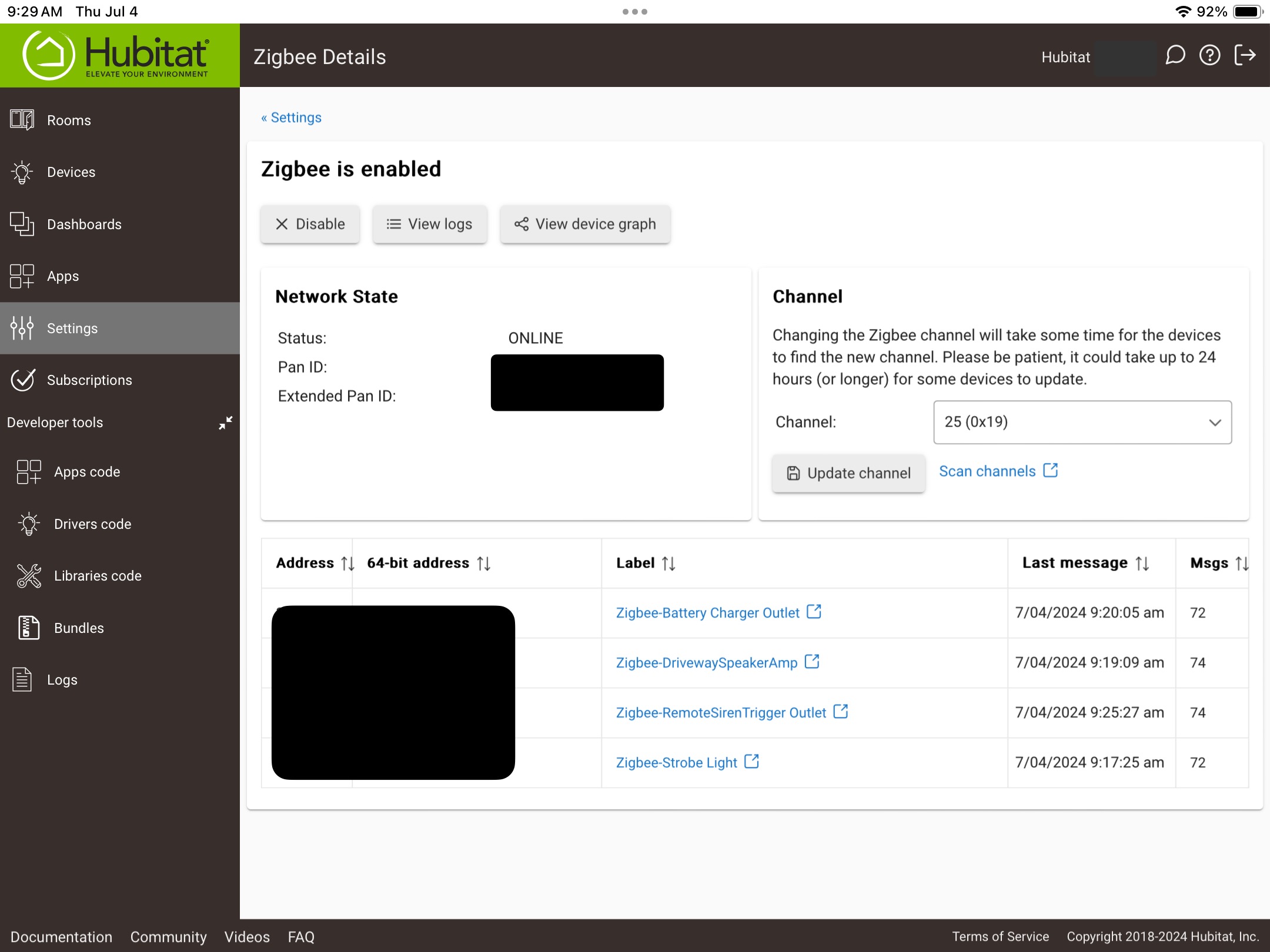

Hub Information Zigbee page shows that the plugs show up on the Zigbee status page showing that the devices are connected (again, see attached photos of Zigbee Graph and Zigbee Status page). Problem is that although the plugs show as connected and Zigbee page shows that the Zigbee Network is “online”, the plugs are not responsive.

The statistics on the Zigbee status page show that all four plugs are sending some kind of messages to the hub..

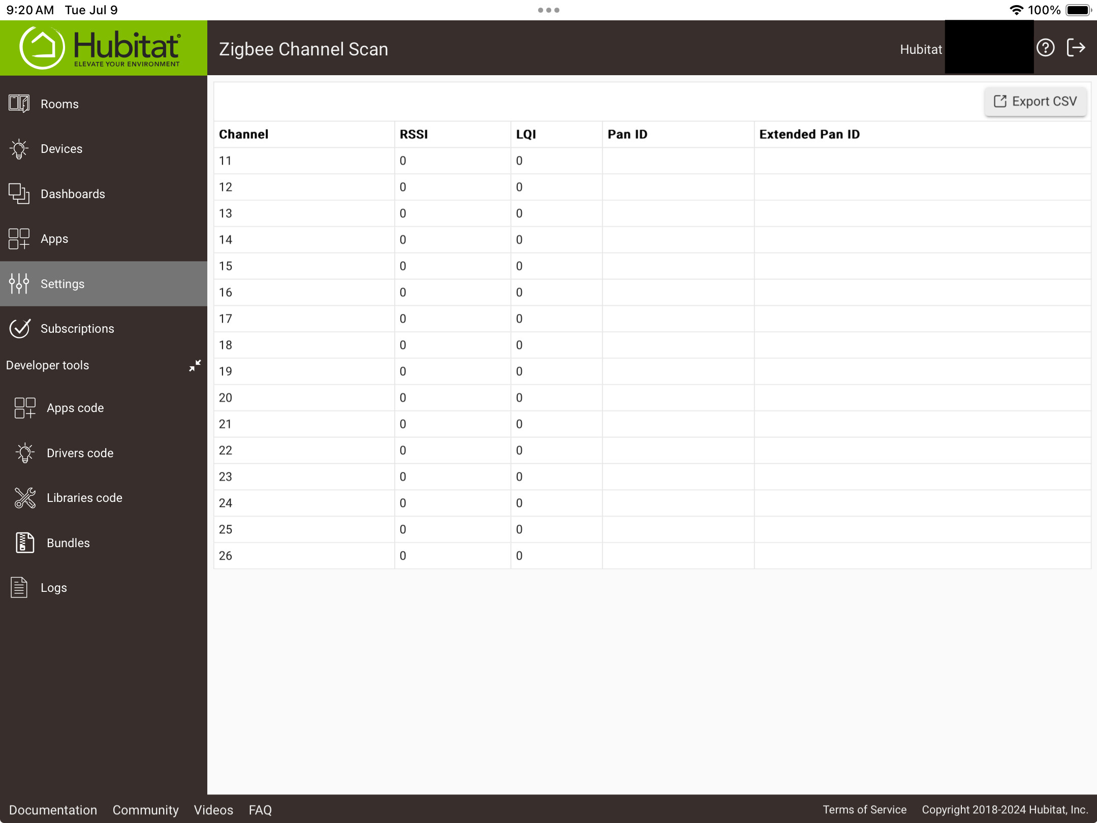

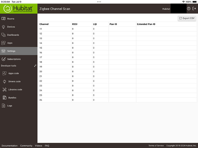

Very interesting finding. Even though (please refer to previous Zigbee Status page photos I attached) Zigbee radio is ON and devices (outlet plugs) show as mapped with messages sent/received, as well as the showing up on the Zigbee map, when I did a network scan, no hub shows up (see attachment). Once again, I am reaching out to anyone on staff that can comment. @bobbyD or @gopher.ny ? Again, TIA.

The scan showing nothing is not indicative (necessarily) of a real problem as many of us have seen that off and on - sometimes it just doesn't work.
