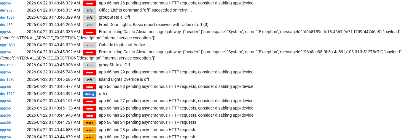

Over the past few weeks every switch and dimmer (lights and fans) in my hub turn on at the same time, completely unexpectedly. Many times it's in the middle of the night. When it happens i either ask alexa to turn things off or i load dashboard and try to tap everything off individually - but things are very unresponsive. I can't figure out why it's happening. I have plenty of log. The only obvious thing i see is /after/ things are turning on are dozens of Alexa errors.
for example in the log i see things starting to turn on (before any errors)
and then a few ms later i see Alexa errors:
h2
but i have no idea if these are the cause or just a result of the breakage.
