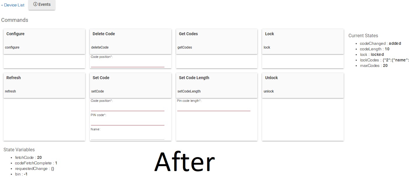

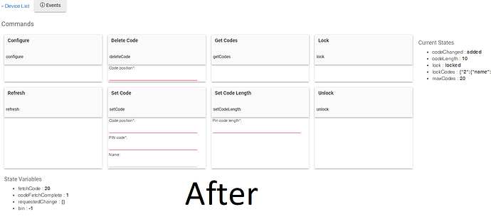

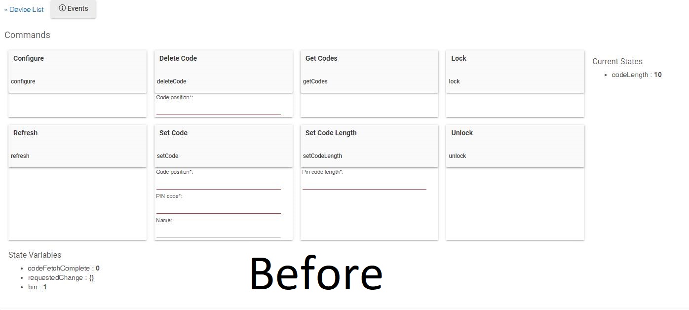

Replaced my module today. Popped the old one out, new one in. My problem is solved. Lock now works with the hub as it should. Lock paired securely even with the hub being "far away". Attached is the before and after device pages showing the difference. Sometimes you just get a bad part.....
Glad this worked out for you!
