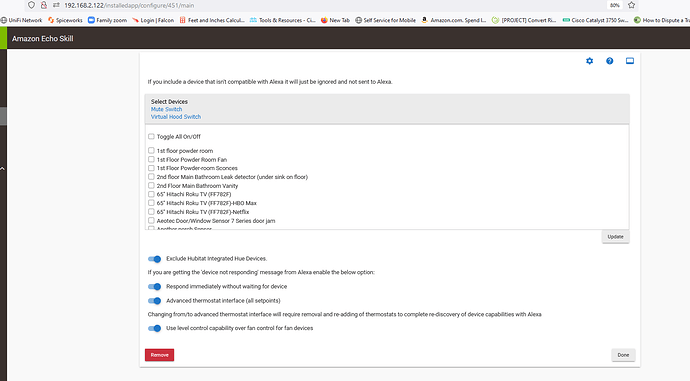

@user1977 You want to pair the osram strip light to hubitat, then in the Amazon Echo skill on hubitat expose that light to alexa. Then you will be able to control it via alexa.

Go to Hub owners - Hubitat, join the group and then post a screenshot of your device page, including Device Information.

As @Ranchitat requested, please post a screenshot of the device page, particularly the Device Details section.
