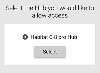

    Upon re-linking I am directed to a login screen, and after login I see:
    This indicates that my login credentials are good, and the Alexa skill is trying to do its job.

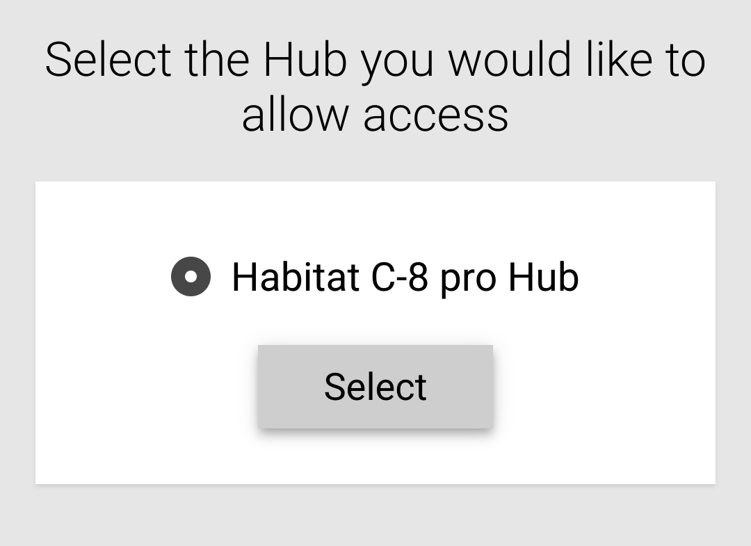

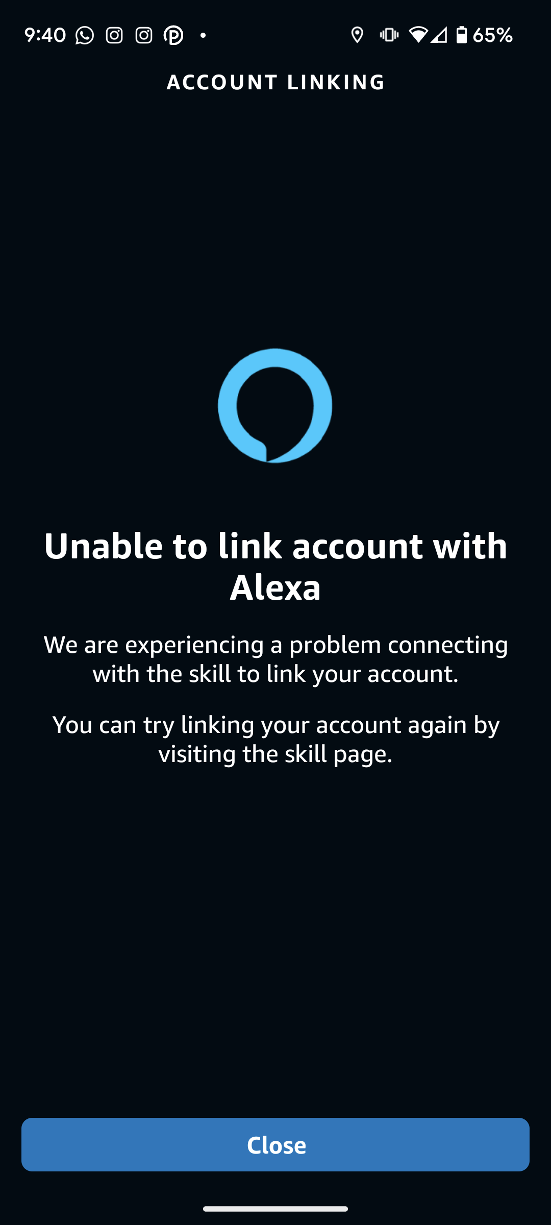

However, after selecting the next screen, I get:
I have retried the process several times, only to end up here each time.

Is your hub communicating with the Hubitat cloud? May want to press the network reset button for about 10-15 seconds to see if that resolves the issue.
Hub_DHCP_reset_button
If not then I'd try a reboot of the router.
When this happened to me on my C-7, I had to reboot the hub 2 times (don't ask me why 2 times, but it worked after the second reboot).
Resetting the hub did the trick! Thank you!
I only needed to do it one time.
Probably only needed to reboot the hub and not the full network reset.
It will do it again, its a known issues right now.
Just reboot next time.
