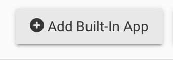

Forgive me if you've already done this. This should do it.
In HE, Go to add built in app...
Add app

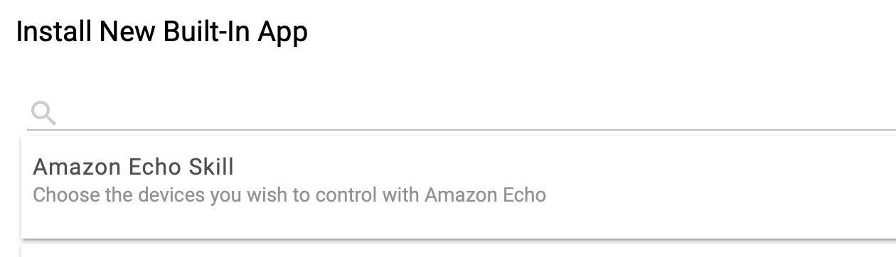

Install Alexa app...

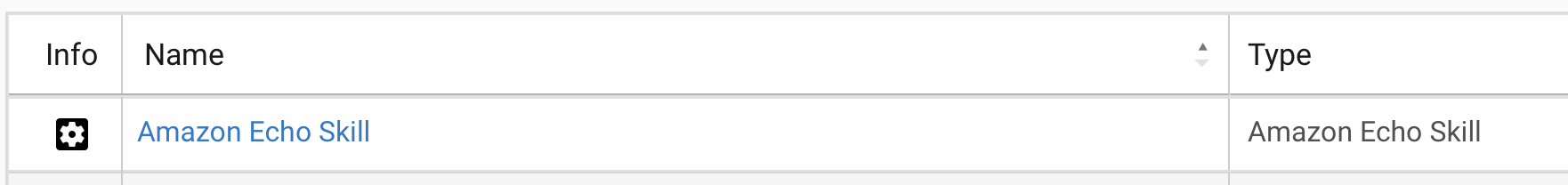

Go to Amazon skill in your app section...

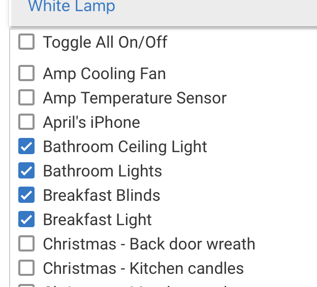

Add the HE devices you want to control with Alexa...
Click "Update" (bottom of this list), then "Done".
