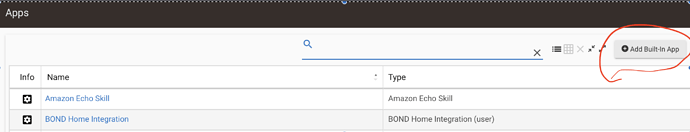

Have you added the Amazon Echo Skill on Hubitat? It's built-in, but you still must add it before turning on the skill in the Alexa app.
Actually, unless something has changed, the Amazon Echo Skill app will be automagically installed on your hub when the Hubitat Skill is enabled within the Alexa mobile phone app. Of course, this only works if the Hubitat Hub is properly registered to the Hubitat Cloud Server, and if the hub has a solid connection to the Hubitat Cloud Server. Often, issues occur when users attempt to set a static IP address directly on their Hubitat hub, without correctly configuring Subnet Mask, Gateway, and DNS Servers. This is why I always recommend users simply use DHCP with a reserved IP address for their HE hub on their router.

- Added the Amazon Echo Skill on Hubitat and selected all devices available
