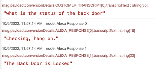

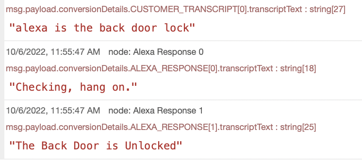

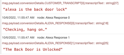

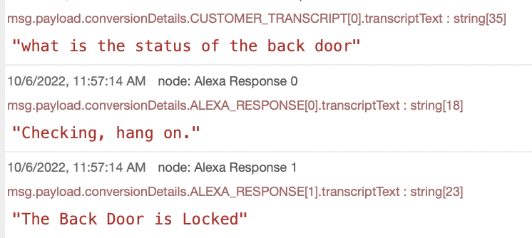

I captured the conversation using one of the Alexa-Remote nodes for node-red.
Query Lock Status when it is unlocked
Command to lock
Query Lock Status again
