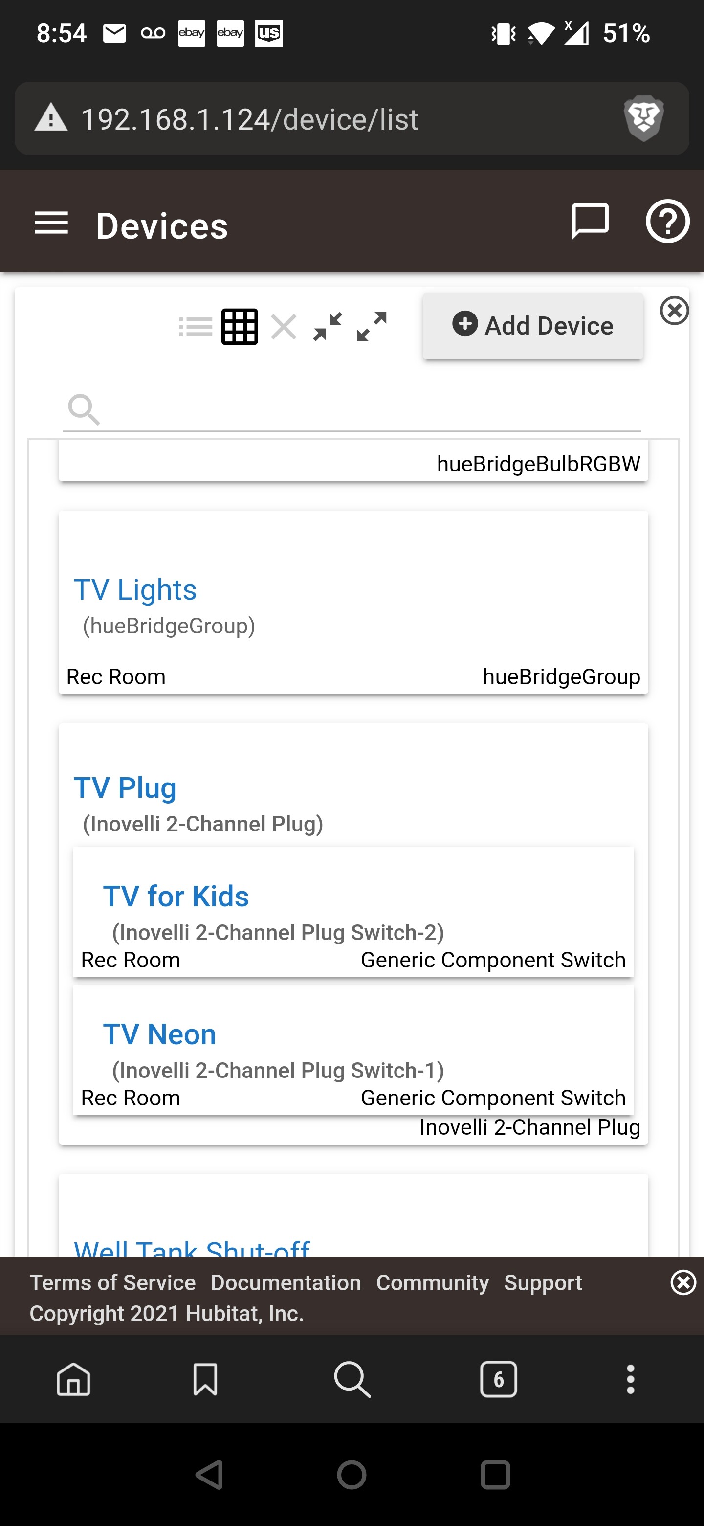

I have a Minoston mp20z. It's a dual outlet device. The child device type (which I can't change) is a "generic component switch". This same wording shows up in the Alexa app for " description".
I want this device to show up in Alexa as a plug. I can't switch the type in Alexa (except between a light or a switch). I think the driver device type is a mistake.

SmartThings had the ability to manipulate the description. In Hubitat that translates into the device type it seems.
I tried it out and a virtual switch (seems like the only option) shows up in the switch area in Alexa.
I wonder if I can get the driver source and tweak the sub device type for this dual plug? Maybe just changing that name will solve it.
Yes, needs to be done through Virtual Switch (which operates as an outlet).
Right... But then Alexa thinks it's a switch not a plug and I am back where I started. The device type name, for the Alexa integration gets mapped in Alexa as "description". It seems that description is what decides if it's a switch or a outlet.
