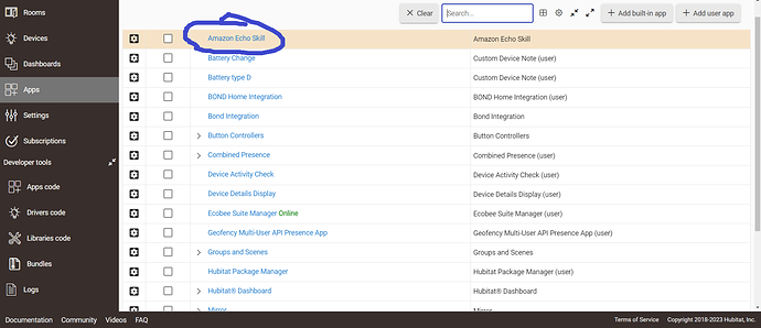

You add devices to Alexa from habitat via the Amazon Echo Skill in HE. Once you install the app and add a device it will show up in the Alexa skill as a device. It is not discovered through the Alexa app.

Perhaps try uninstalling the Hubitat skill in Alexa and re-linking your account. Once that is done adding a device never ask for a hub, so I am not sure what is gong on.
You add the device to the Amazon Echo skill in the HE app. Once you add it there, it's done. Its working for me and I have seen no one else post an issue about it not working.
