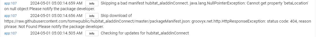

HPM generates an error when it checks for package updates:

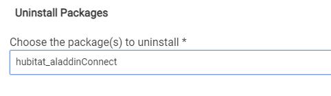

When I check HPM, it indicates there is a package to uninstall:

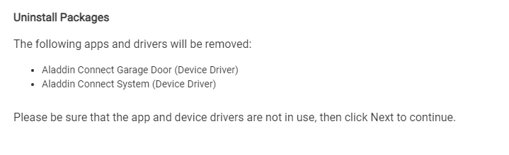

The uninstall prompts me to make sure apps and drivers are not in use.
As noted, there are no devices, no apps, and no drivers that I can find related to Aladdin Connect.

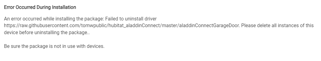

When I continue with the uninstall in HPM, I get this error:

You told HPM to manage the code for you, then you manually managed the code. HPM still thinks it is the manager of the code, but the code is gone. :slight_smile:
Use UnMatch to tell HPM to stop managing the code.
Perfect. I guess I did get ahead of myself.
All is well now. Thanks much for the help.
