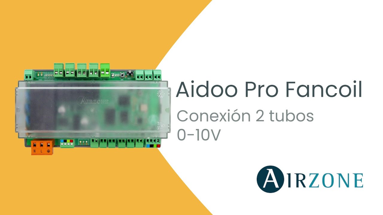

I am building a new home and currently installing the daiking fancoils, they are 2 pipe 0-10 controll
I saw on internet for something that i could integrate in hubitat but didnt found anything
The only thing i found was an airzone aidoo pro fancoil witch had 2 temp sensor one for water temperature at the tube and one for the air also the 0-10 fan controll and Nc valve
If i get this product can i implement in hubitat or should i chose other product

Here it is a pic
