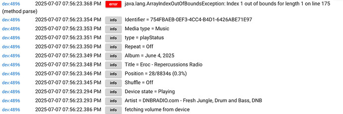

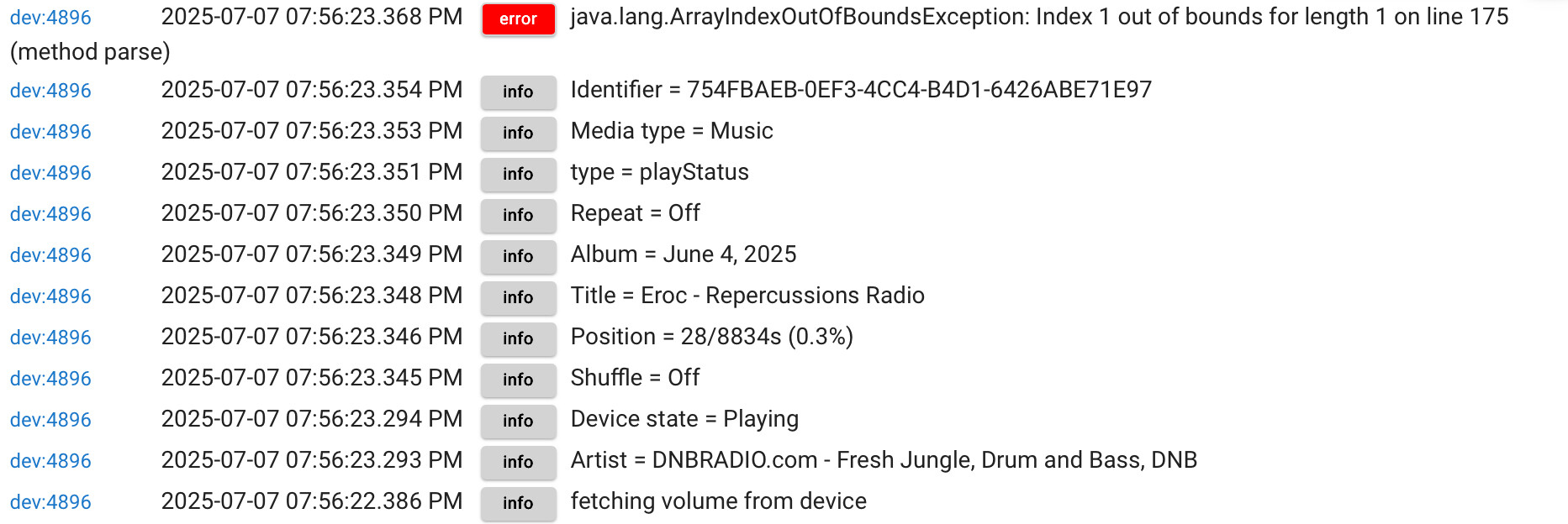

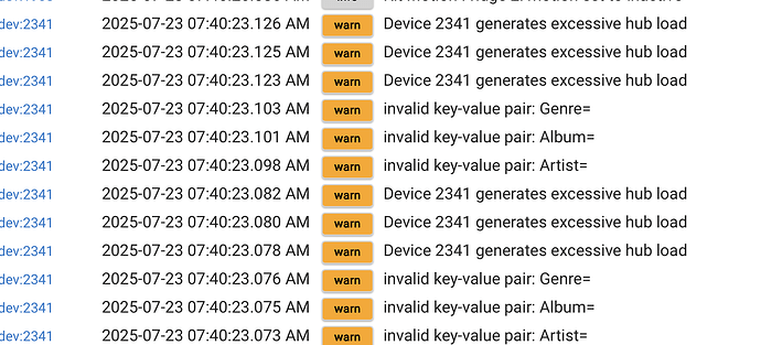

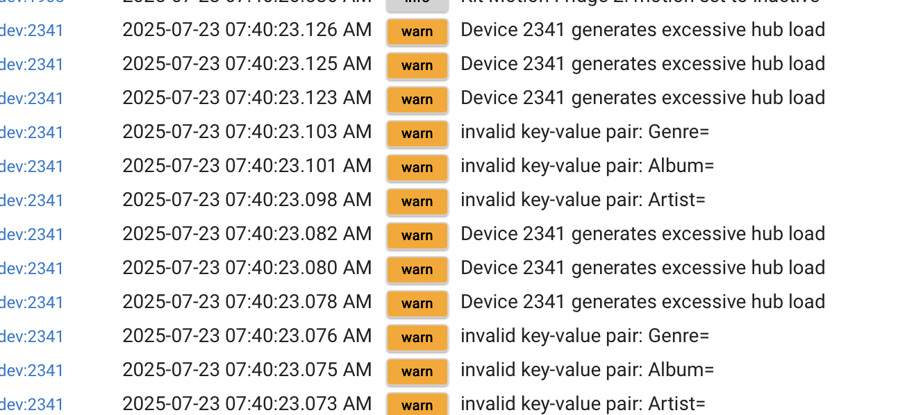

i’m getting the following error in my logs on doing a refresh or changing the volume on 2.4.2.125 to an OG homepod running 18.5. Volume does change successfully.
java.lang.ArrayIndexOutOfBoundsException: Index 1 out of bounds for length 1 on line 175 (method parse)
@gopher.ny @bobbyD

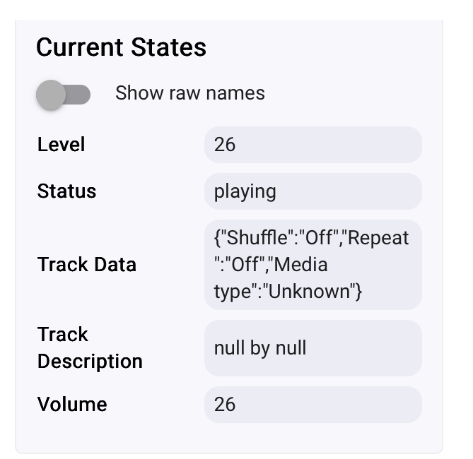

Should theses “states” in the logs be updating the current state of the device or is this a part of the ArrayIndexOutOfBoundsException error?
It seams like several of them should be populating the track data / description states that aren’t like; media type, album, title and position.
Yeah, there should be more information in track data.
Can you PM me the hub id?
Next build should have the fix for it.

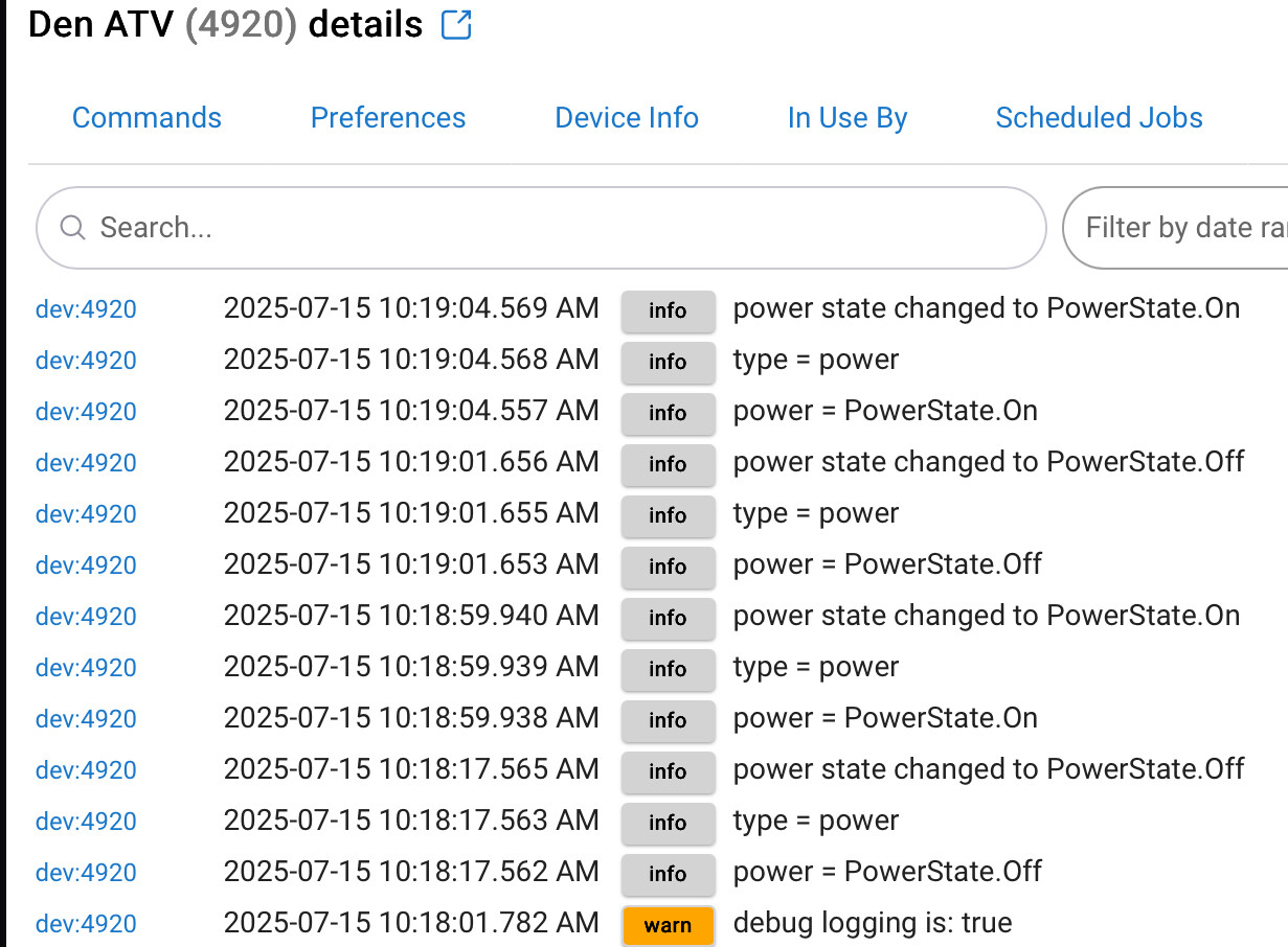

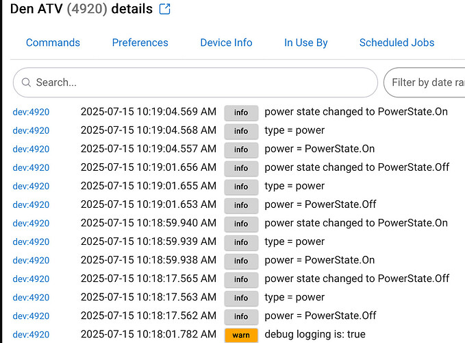

As a feature request, can you add powerstate reporting for airplay devices that report power state? Maybe just as a status? It would be awesome if power state could be controllable too, but i can appreciate if it’s out of scope for the current implementation.

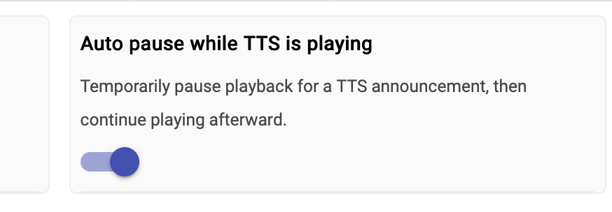

The auto pause works great!
The volume is maintained as well (I have the radio playing at 30, the announcement comes on at 100, and then it resumes playing the radio station at 30).
