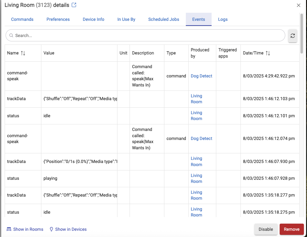

It seems that when the unit doesn't play a message is when I get that 'Internal Error Occurred'. So what does that mean? Is it referring to the device, the driver, the app????? Could help the troubleshooting if I knew where that was coming from.. @gopher.ny
Here is a screen shot of the events on one of the pods. The speak command at 1:46 worked fine. The one at 4:29 didn't and the log shows the internal error at that time.
