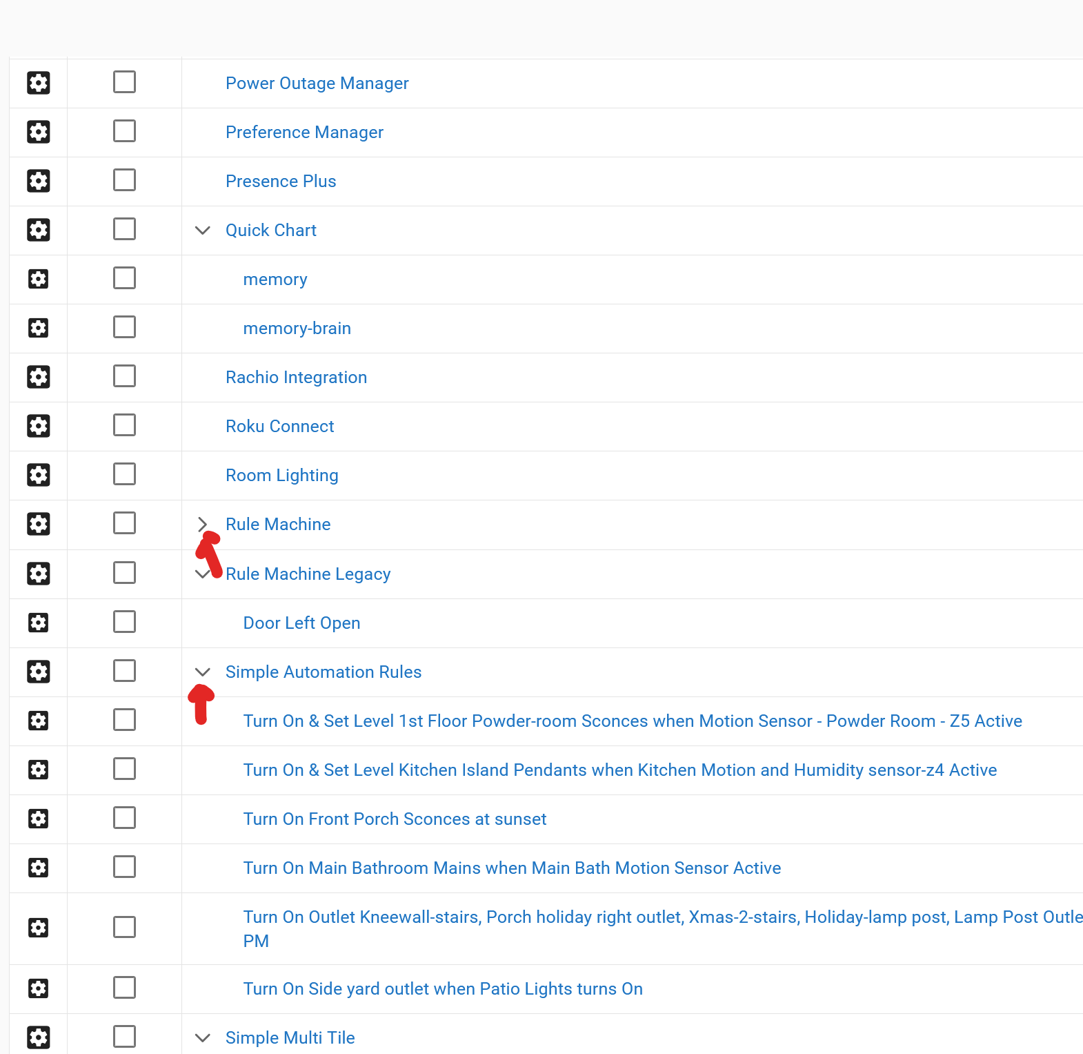

Look at your rules... You will see arrows to click to expand things. It's part of the new UI
Perfect, thank you. That worked.
This comes up so often. I wonder if the UI would be simpler if they moved the ">" to the other side of the name.
In other words instead of
> Rule Machine
they had
Rule Machine >
Or maybe even
Rule Machine > (click to expand)
That being said, you really should have both hubs on the latest firmware before doing the migration.
I posted this as a suggestion in the Feedback section.
