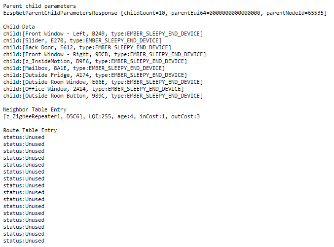

After adding a zigbee repeater
What does it take to get devices to route through it? Do I need to shut the zigbee radio and let the devices panic? Can I just power cycle the device I want to re-route? Do I just wait?
They will eventually discover the new route. If you want to force them to try to re-route through the new repeater, you have to pull power from the hub for at least 20 minutes or longer. Then the devices go into "PANIC" mode and will search for a new route.
I'll wait it out. Someone said their devices chewed through some battery once in PANIC mode and I don't have enough of these CR2s left for the IRIS V1 stuff.
I found just a shutdown of 5 minutes and stuff starting re routing.
Just toggle the radio?
Probably
