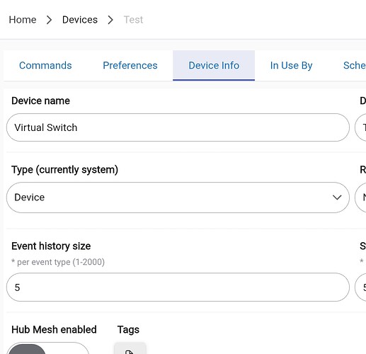

Just a thought. I was having some weird reporting issues with mine after having tried a few different drivers. The issue had been created when I updated some of the settings on one driver that were not available on the other one I switched to. I had a lot of the same issues you were having.
I had to change to a generic "device," (I do not recall the name of it), click configure, and then reset/delete all parameters and then switch back to the driver I wanted to use.
Edited to add that Factory Resetting did not fix my issues either. I HAD to delete all the parameters (indicating to me that the changes being made were being stored on the device itself somehow)

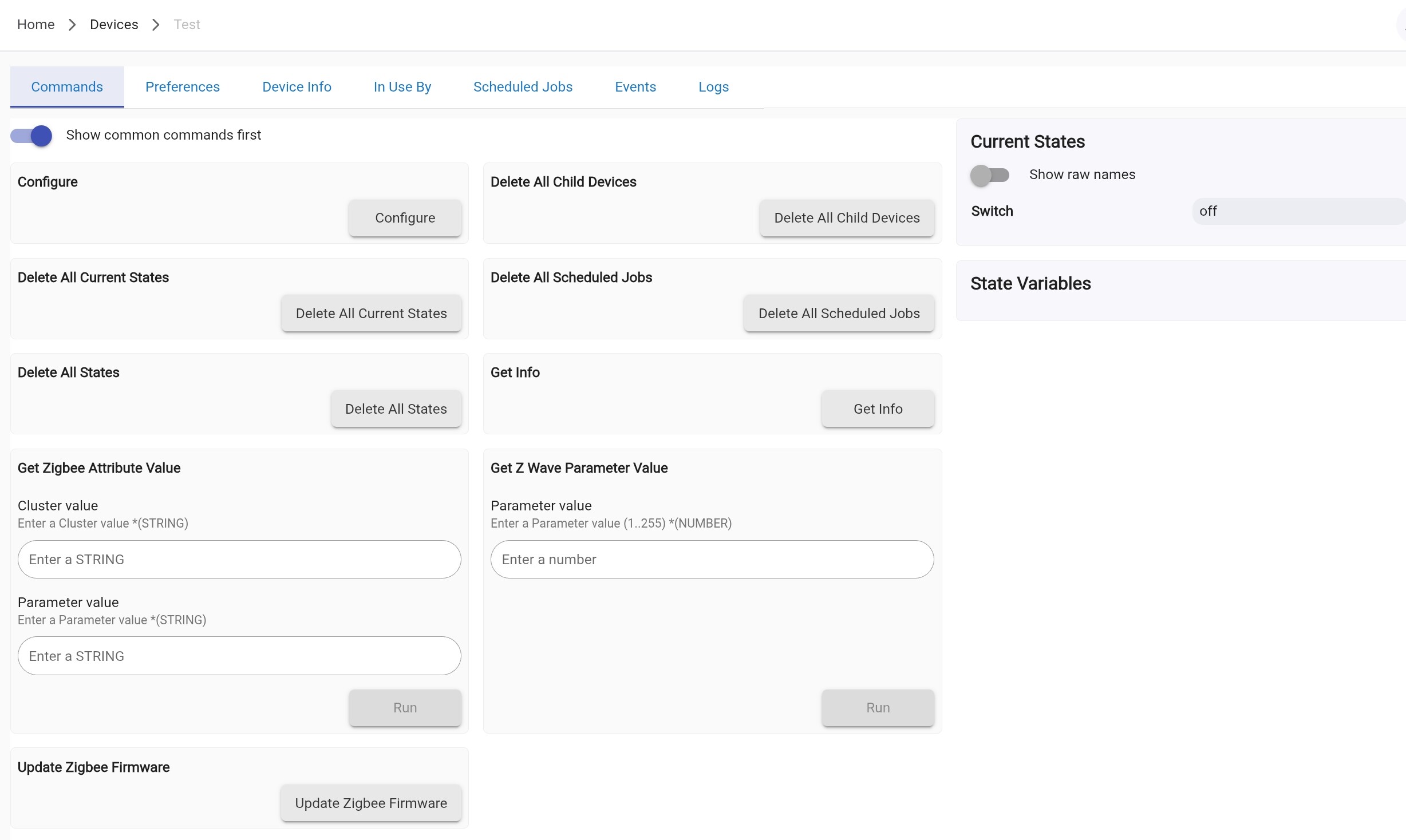

So, it was just "device" in the type. I then went to the commands page and clicked to delete all states and then hit configure.
Then I loaded the driver I wanted to use, hit configure, then I was able to reliably use the new driver and update parameters.
