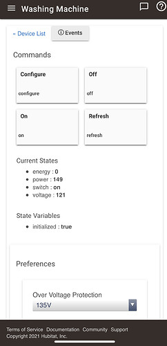

@bcopeland Is it normal for the Aeotec Smart Switch 7 to report energy of 0 even when it has load? I’m using the stock driver provided by Hubitat.
Are you saying it never changes from 0?
Mine stopped reporting power also. This must have been several updates ago bc my automation using power stopped working awhile ago. I just tracked it down yesterday.
Yes as you can see it’s reporting active power of 149 but energy is still zero.
