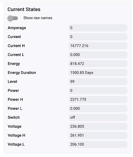

Aeotec Smart Switch 6 + Z-WaveJS = Switch On/Off state not reporting
I was fiddling with some of my outlets after wondering why automations weren’t working and discovered that under Z-WaveJS the Switch On/Off state reporting doesn’t work at all. it looks like the energy reporting is, but not even a “Refresh” will update the Switch state.
@bcopeland
Im running a:
  • C8 Pro with HE 2.5.0.153
  • Z-Wave Firmware version: 7.22.2
dev:14242026-06-06 9:26:08.953 am
debug
BasicReport(value:99)
debug
dev:14242026-06-06 9:26:08.408 am
debug
ignore: SwitchBinaryReport(value:255)
dev:14242026-06-06 9:26:08.358 am
debug
on()
dev:14242026-06-06 9:26:02.915 am
debug
dev:14242026-06-06 9:26:02.909 am
debug
dev:14242026-06-06 9:26:02.365 am
debug
dev:14242026-06-06 9:26:02.304 am
debug
on()
dev:14242026-06-06 9:26:01.155 am
info
Range Hood current is 0 A
dev:14242026-06-06 9:26:00.175 am
info
Range Hood voltage is 236.805 V
dev:14242026-06-06 9:25:59.152 am
info
Range Hood power is 0 W
dev:14242026-06-06 9:25:58.389 am
debug
dev:14242026-06-06 9:25:58.363 am
debug
dev:14242026-06-06 9:25:58.155 am
info
Range Hood energy is 818.472 kWh
dev:14242026-06-06 9:25:58.152 am
info
Range Hood energyDuration is 1500.85 Days
dev:14242026-06-06 9:25:57.820 am
debug
dev:14242026-06-06 9:25:57.766 am
debug
on()
dev:14242026-06-06 9:25:57.091 am
debug
dev:14242026-06-06 9:25:57.030 am
debug
refresh()
dev:14242026-06-06 9:25:55.355 am
debug
dev:14242026-06-06 9:25:55.354 am
debug
dev:14242026-06-06 9:25:54.811 am
debug
dev:14242026-06-06 9:25:54.753 am
debug
on()
dev:14242026-06-06 9:25:53.830 am
debug
debug
dev:14242026-06-06 9:25:53.310 am
debug
dev:14242026-06-06 9:25:53.234 am
debug
on()
dev:14242026-06-06 9:25:52.259 am
debug
dev:14242026-06-06 9:25:52.257 am
debug
dev:14242026-06-06 9:25:51.706 am
debug
dev:14242026-06-06 9:25:51.647 am
debug
on()
dev:14242026-06-06 9:25:40.885 am
debug
BasicReport(value:0)
debug
dev:14242026-06-06 9:25:40.338 am
debug
ignore: SwitchBinaryReport(value:0)
dev:14242026-06-06 9:25:40.276 am
debug
off()
dev:14242026-06-06 9:25:08.102 am
debug
debug

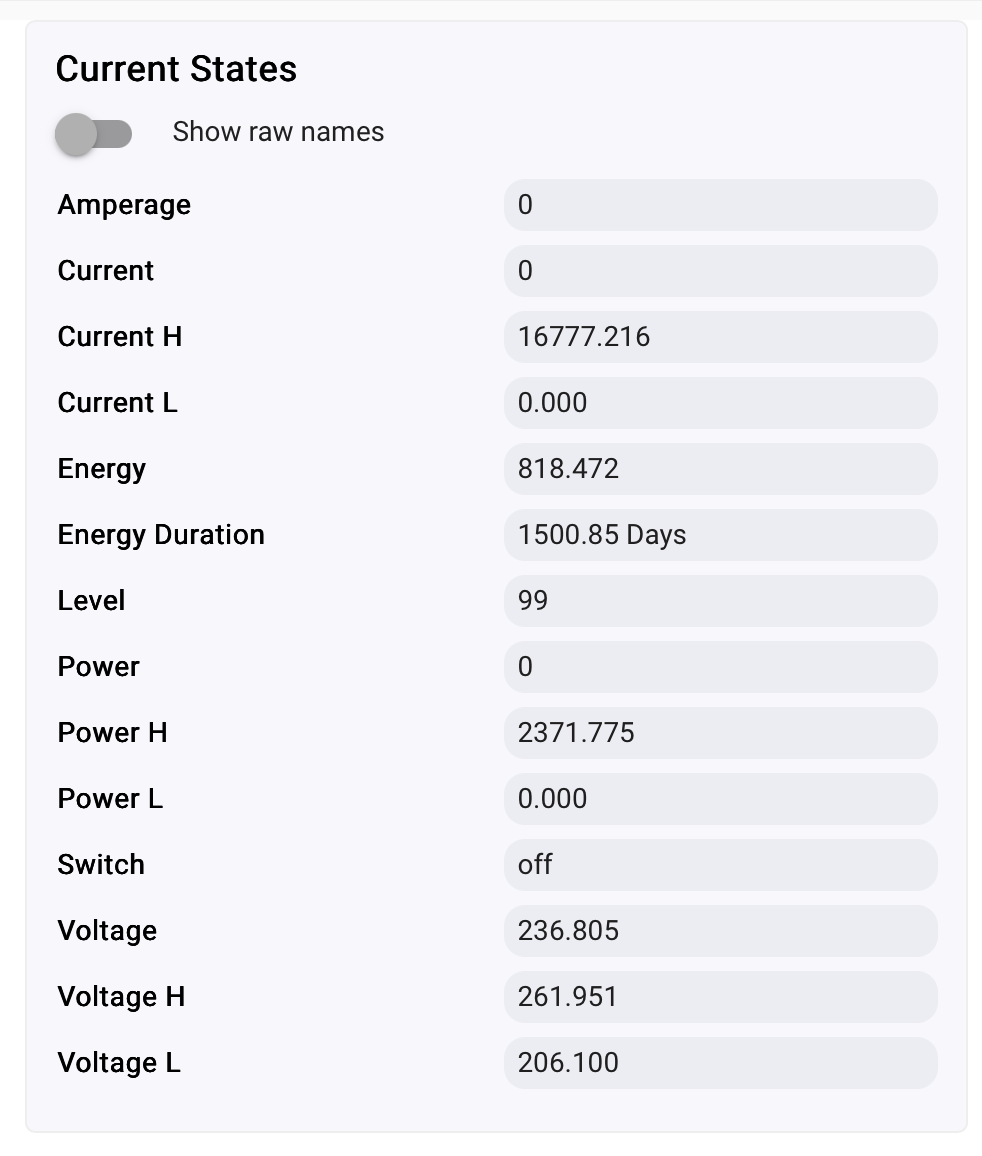

Prolly helps if if clarify this is what I meant. :man_facepalming: Thread title updated too.
