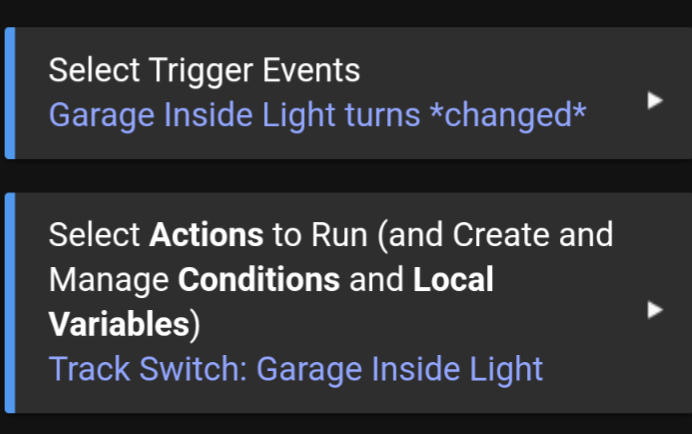

Try a quick rule like this. It helped keep my Google home assistant in sync. But appears to no longer be needed. Not sure what changed wether it was going to x.164 or the zwjs stack or some previous rev. May not help at all as is the case with zwjs and the universal z-wave dimmer driver.
Unfortunately i use the electric reporting (which is working). Thanks for the suggestion though.
