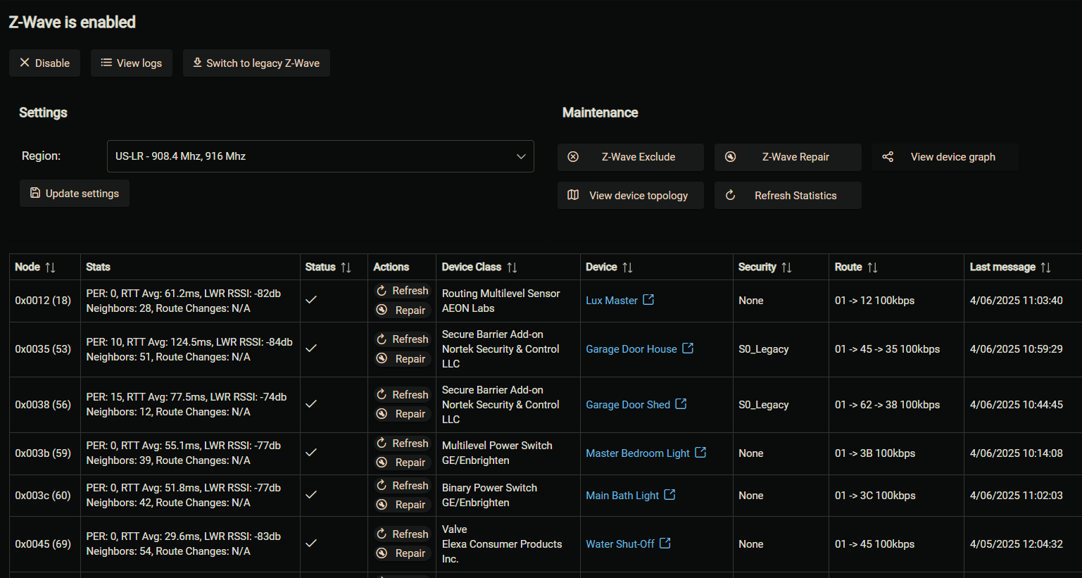

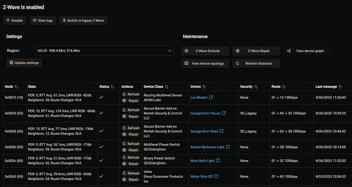

I don't think there is anything routing through it but on JS I don't know how to tell.
ZIP had the wonderfull ZW Mesh app.
How did you get your app to list information grouped like that?
That's just a snippet from the Settings | Z-Wave Details page.
I was hoping it showed # of devices routing but it doesn't.
My settings/details page looks nothing like that.

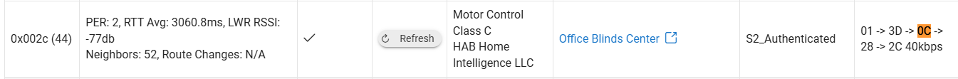

A bit more tedious than the ZW Mesh app, but you can grab the a device ID on the ZW Details page and then do a CTRL-F search on it to highlight devices routing through it...
Exampe from mine: Acting as router...
Routing through it:
Great idea.
I have one iBlind on the opposite side of the house routing through it; pointless.
