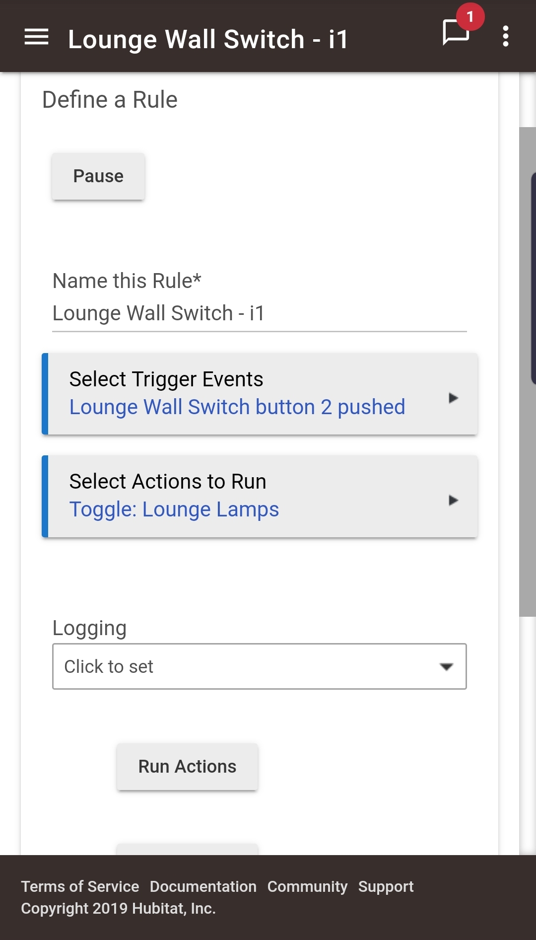

Question for you though Steven - I'm still getting a slight delay using the 2nd input. Input 1 is immediate. Makes me wonder if it's the rule. Interestingly the triple press (button 3) seems to be the slowest to respond (2-3 seconds, sometimes longer).
I have a scene set which is essentially 50% brightness of the downlights (the load connected to s1) and the Lounge Lamps (2 Phillips Hue globes). This creates the scene as a 'switch'. One rule I have is to toggle the switch (the scene).
Mind telling me how you're using the s2 input?

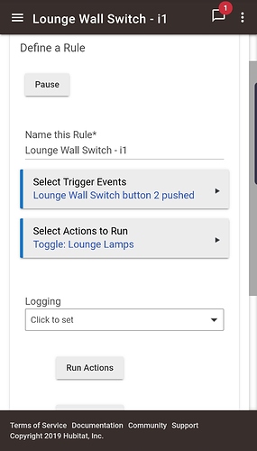

This is one of my rules, basically just: upon button 2 press, toggle switch.
If I use a dashboard tile to toggle the same switch they are immediate. But using the rule linked to the wall switch it is delayed (~2 seconds). Which doesn't seem like much but forever when you're standing in the dark waiting.
