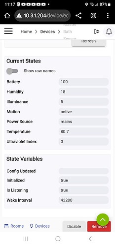

I added them to my Habitat (C8), but have been unable to use them using basic rules. The device shows up when creating a motion rule, but the action is never initiated.

Have you seen motion go inactive or is it always stuck on active? Just wondering because your screenshot shows it active, and that would explain why the automation is not working if it is stuck.
Thank you for the quick response. The device always shows active.
I thought it was supposed to be that way.. Ooops. What needs to be addressed.

I'm curious why is says its on mains.

The issue is that the sensor gets stuck in active mode. It won't release this connection.
Per the MS7 user guide, if changed power source after pairing, you need to exclude & re-include to properly identify the device's power source.

The device stays active, and won't clear for long periods of time.
