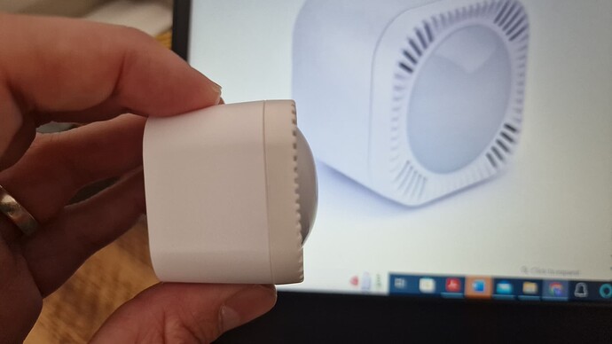

On a side note, I can't believe for a device costing £65 has arrived in such a state. Mine also has a 'cream' colour plastic front which I wasn't expecting (all the images show it as pure white) which is really going to stand-out agains my white walls, not sure if they are making cutbacks by buying cheaper materials, or mine has some sort of fault there too. Unbelievable for such an expensive device.
