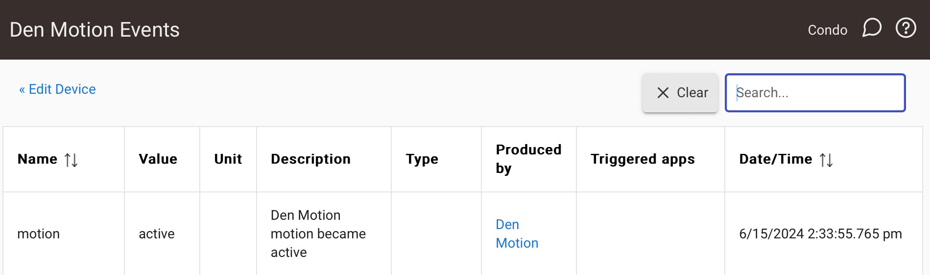

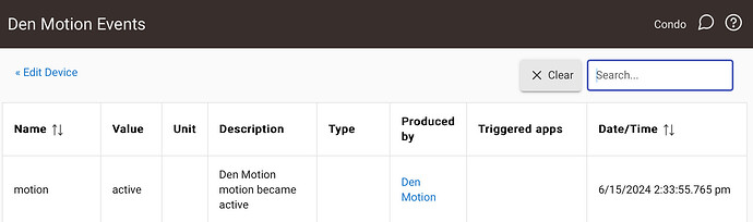

As title. Motion events are recorded in Events while debug logging is on, and are not logged while off. Temperature, humidity etc work as expected all the time. Would love this fixed as it's a nice but not cheap device!

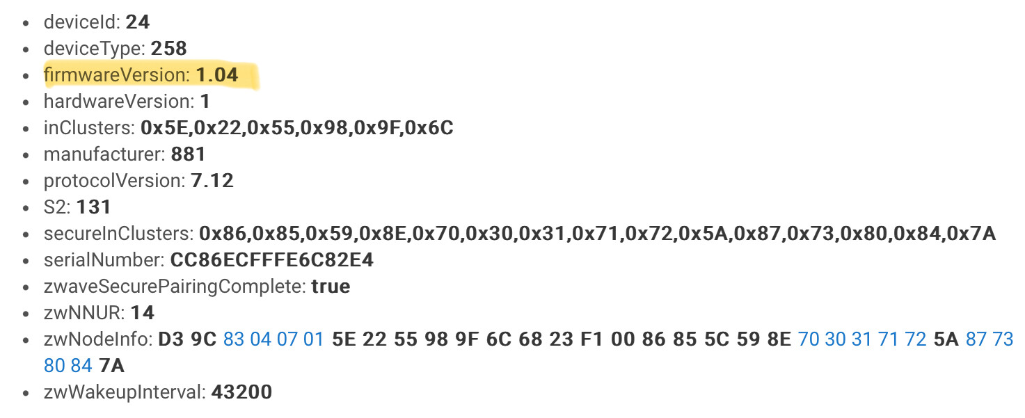

If the firmware version on the device does not show 1.04 aka 1.4 or greater you maybe due for a firmware update. Also try rebooting the hub

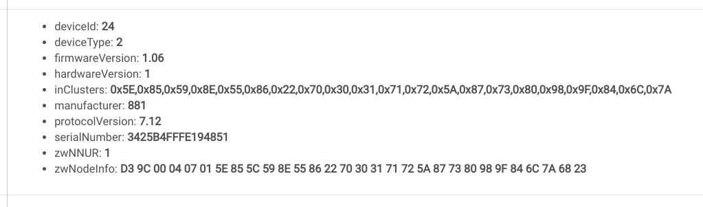

The firmware on mine is 1.06 I've been through the rebooting, restarting radios, factory resetting device etc. I wonder if I might try it on a generic driver for a while to see if that catches motion. Might help to narrow down where the problem is.

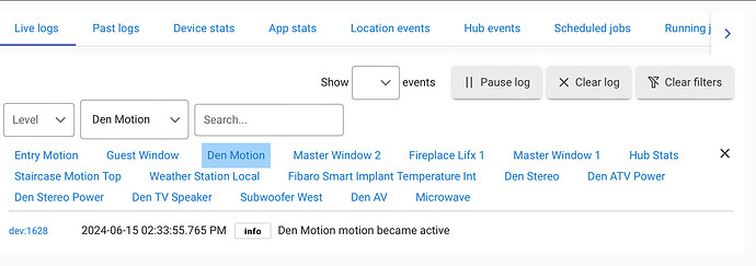

The device is sending motion events on the Generic Z-wave Motion driver. I've checked for updates on Hubitat's main and z-wave updates options.
There's a noticeable delay but that might be because unusually I have this one battery powered and it probably takes a while to wake up.

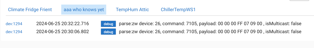

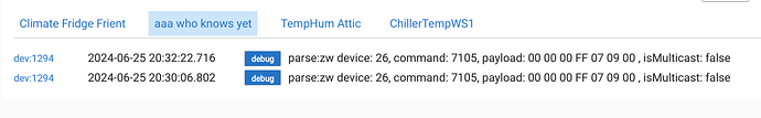

When I try to provoke a motion or acceleration event by tapping the device on the shelf it logs the following line but registers no event:
The device offers the following details
