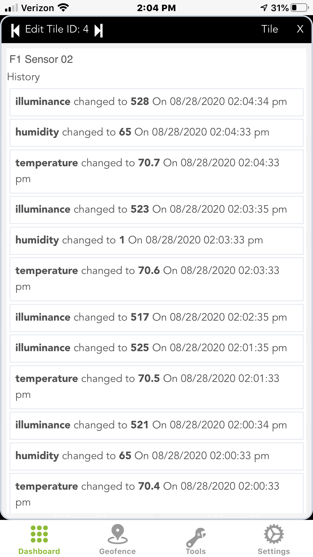

Also, Humidity can go from normal (50%) to 1%

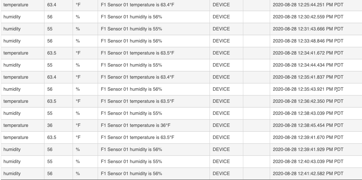

Here's an example. This is only a slightly crazy reading. Look at 12:38:45 and the two surrounding temperature readings. My room went to near freezing and back in a couple minutes! Haha..

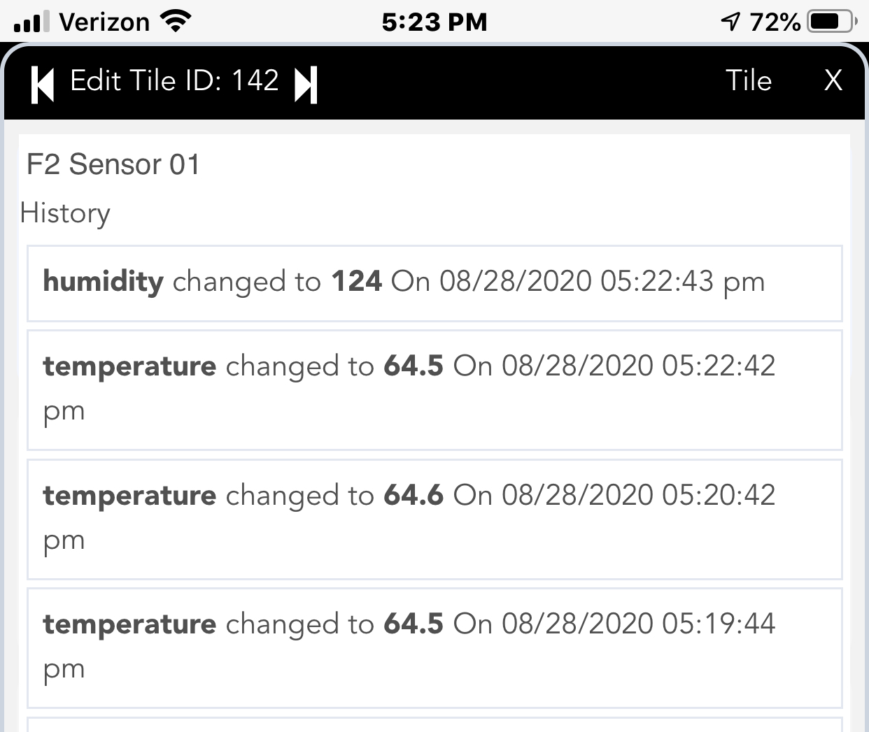

Here is another weird reading that just happened. This one is humidity.
Now we’re at 124% humidity.

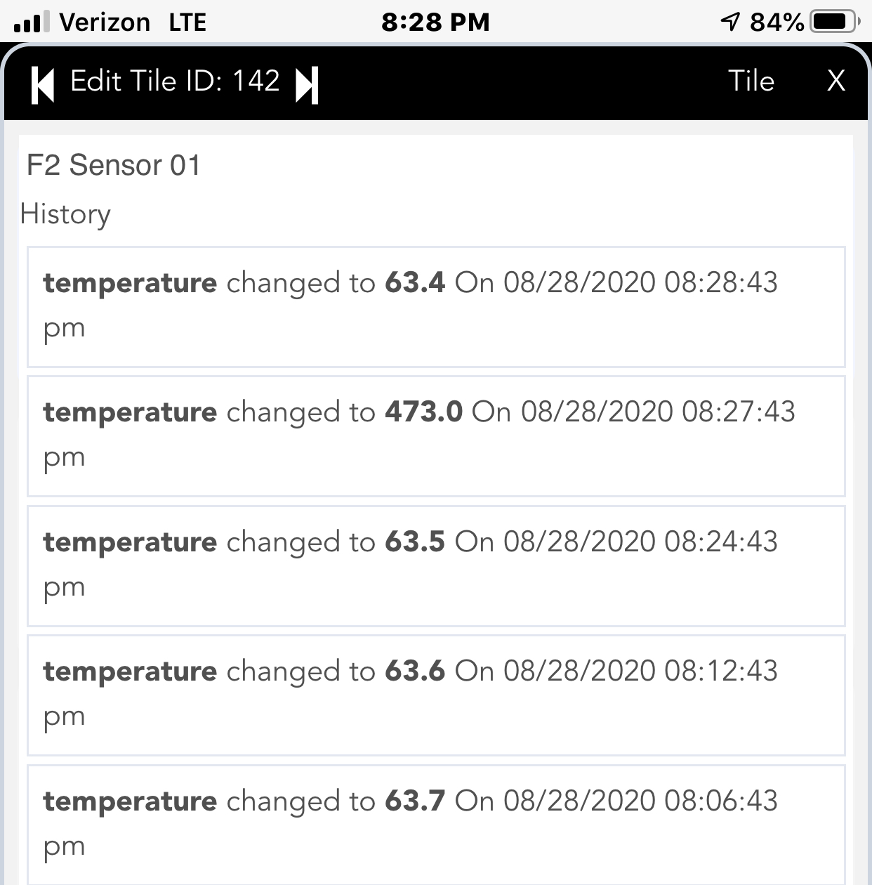

Mostly I get good readings. Cannabis grow room (legal in Oregon). I have 4 sensors In one room and 2 in another. Mostly they line up just fine with their readings. But then I get a 480 degree temperature on one of them and I check the cameras to see if the room is on fire.
