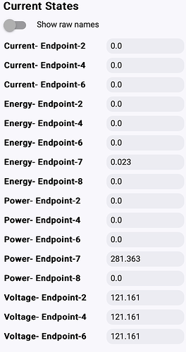

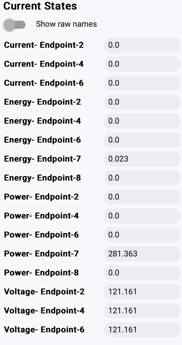

I have just installed the Aeotec Energy Meter 8 and had 2 problems.
The first was that it wasn't appearing in Sharptools. I solved that by adding, capability 'Sensor' to the main driver code.
The second problem is that, Total Amperage, Power and Energy are all showing 0, but the endpoints all appear to be correct. I have tried every combination of Parameters I can think of without success! I need the totals to report so I can send them to InfluxDB.
Does anyone have any suggestions!
Every time I look at this thing my head starts hurting. ![]()
Which is to say, I'm just taking a shallow stab at it:
Do you have the CT's installed correctly?
I am pretty sure I do as the correct phase readings appear under Endpoints 1,3 and 5 and the toal in Endpoint 7 This is what stumps me as if they ready correctly why is the total W and KWH still reading 0 on a three clamp device! Even if one is the wrong way around it should still read something!

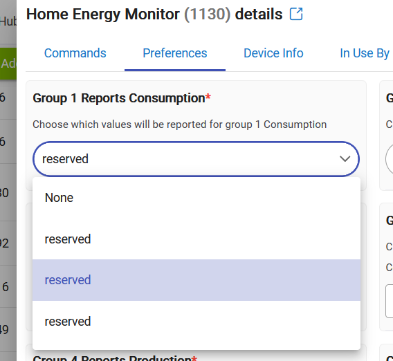

Hi @42.42.bb3
What are the group report values you have? I have 50.529.027 on group 1 consumption and 202.116.108 on group 2 consumption. The rest I have at zero. The group 1 interval at 3600 and group 2 at 7200, rest zero.
Did you try to enable debugging and see what is shown in the logs?
