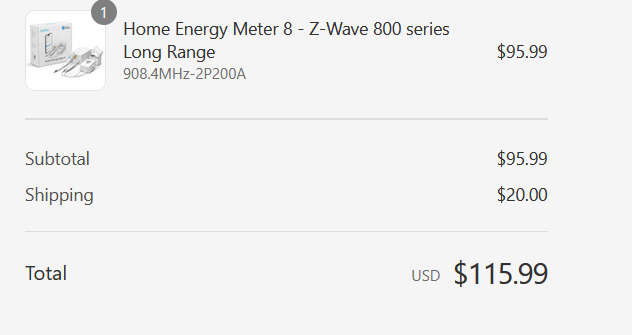

Found it on the Aeotec store:
not clear i know the clamps changed btween the 100 series what if you have the older 500 series?
Have a China tracking number.
Somehow I was under the impression Aeotec was European.
Maybe it is, but unit is being drop shipped, if that's the correct term.

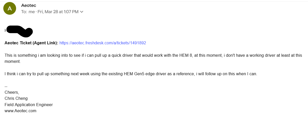

I received this response from Aeotec:

I received a reply from Aeotec.
Cut and paste below.

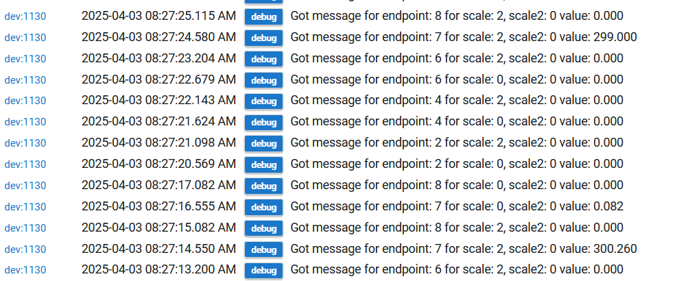

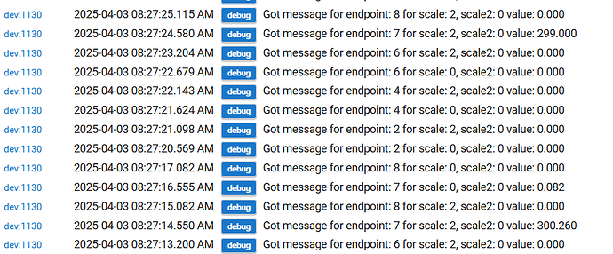

Attached is a screenshot of how the values should show up in this driver, do a "Refresh" and it should update every single available value. As per the parameter settings - i have not yet tested the configurations to see if they are working properly (but i have only included Parameter 101 - 106, and 111-106)
Debug log values change but info, not.
Still have to refresh to get a value to show on dashboard, for instance, or the device tab.
