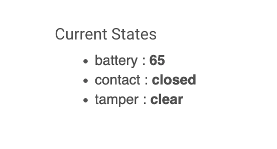

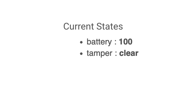

I noticed immediately, that the sensor isn't responding to open / close requests. The Aerotec driver added right away but it did hang a bit on initializing for a moment and I'm wondering if I just need to exclude it and re-add? I noticed that there isn't many states to report compared to the Gen5, on the devices page there are more states that report.

7 Pro (Aeotec Door/Window Sensor 7 Series driver)

Gen5 (generic z-wave driver)

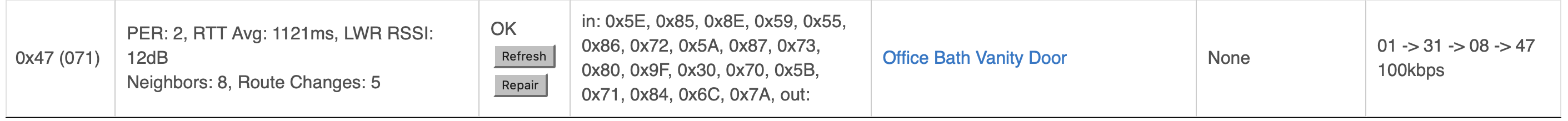

Don't know what to say. I have several DWS7 (non-pro), and I just got and added a DWS7 Pro this week. All work fine. I tried to get a DWS7 non-pro, but no one seems to be selling them any more.
I was able to pair it in place, didn't have to get it close to the hub. Did not use SmartStart, instead used Classic Inclusion. C-7, 2.2.7.128. The DWS7 Pro is in a bathroom with tile walls, so I'm impressed that the speed is 100kbps.

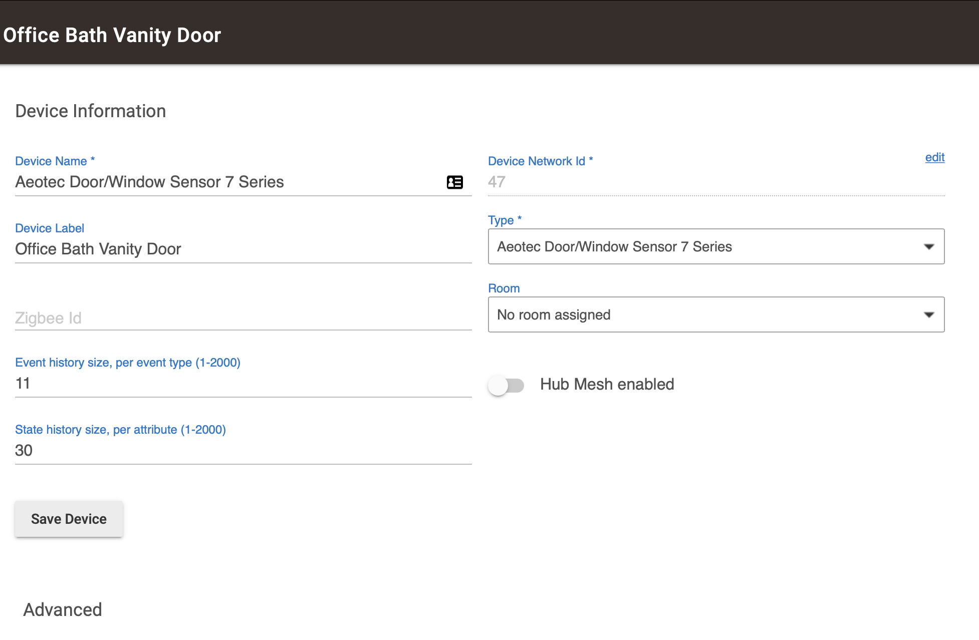

As for the driver I'm using:
Thanks for the reply @672southmain on a whim I decided to use the generic z wave drive, same as on the Gen5. Once I did that, I was getting open / close events. It's been sitting at 100kbps so that is really nice to see. I'll experiment a little more with the driver and see. Maybe I'll exclude it and re-add it just to play with it. These seem a little more sensitive. I'm not a fan of the little toggle switch to wake the device, etc.
