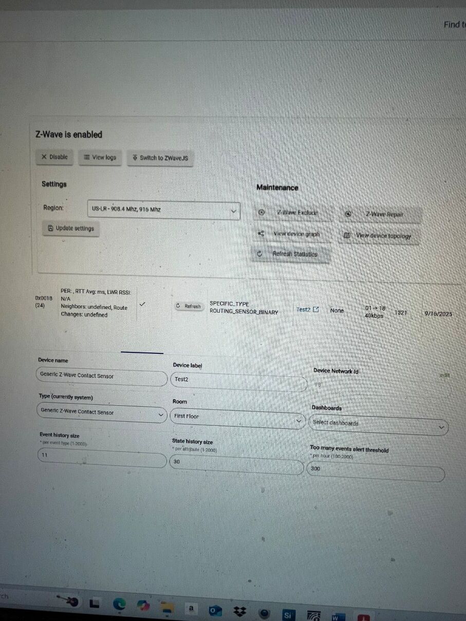

Good place to start is with the ZWave Details page (under Settings). Can you post an image of the page?
Is that what is listed in the Device settings page, Device Info tab, and in the "Type"? In other words, what driver exact name is this using?
If it says Device under the Type, then it chose the wrong driver.

Z-wave = US-LR - 904MHz, 916 Mhz
Specific_type Routing_Sensor_Binary
Type = Generic Z-Wave Contact Sensor (inclusion picked)
Hopefully that answers most . . .
Let me know what else I can forward. Wish the image.
Can you try it again now? I just gave your account image posting privileges.
You have just a single z-wave device? Also, it is much easier to post this as screenshots, rather than take a photograph of your screen using a camera.

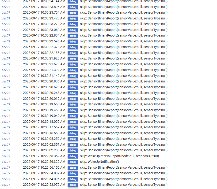

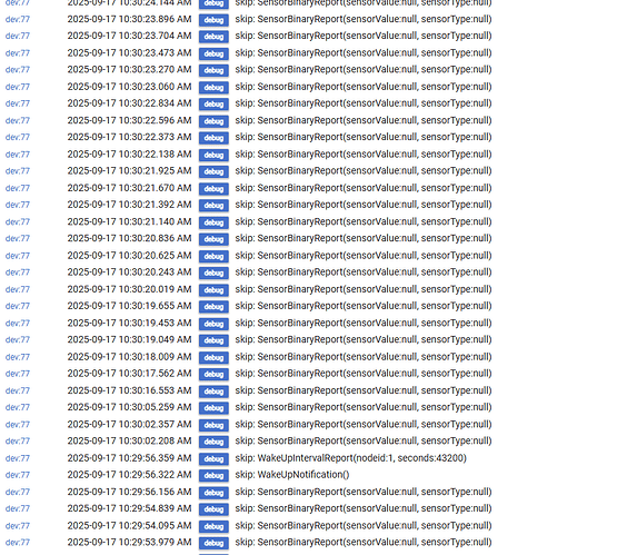

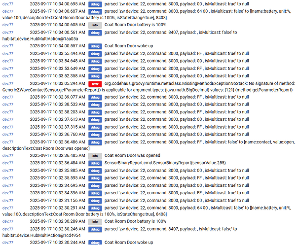

Also, turn on debug logging on the device settings page, then open and close the sensor. Get a screenshot of the debug logs that result from that.

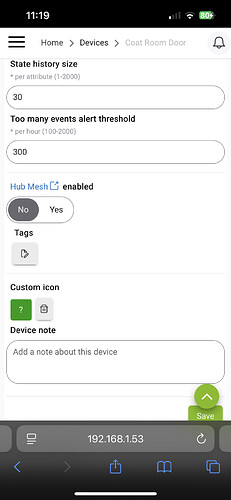

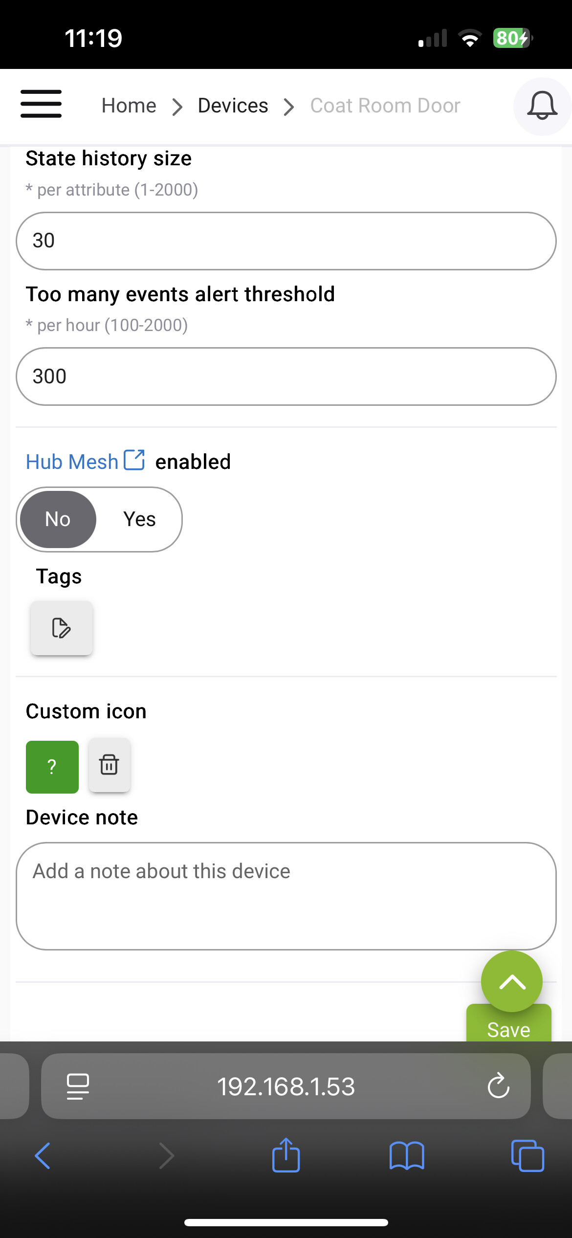

Sorry for the phone screenshots. Was no longer by a computer and wanted to give you what you asked for. Only gave you a couple shots from the log. Need more let me know. Nothing is reported after the one contact it appears to me.

Stick to that Generic Contact Sensor driver, the issue is not with the driver, I can see the messages in the debugging but the platform is not parsing them correctly.

I would like to see a bigger view of the logs from a PC screenshot please.

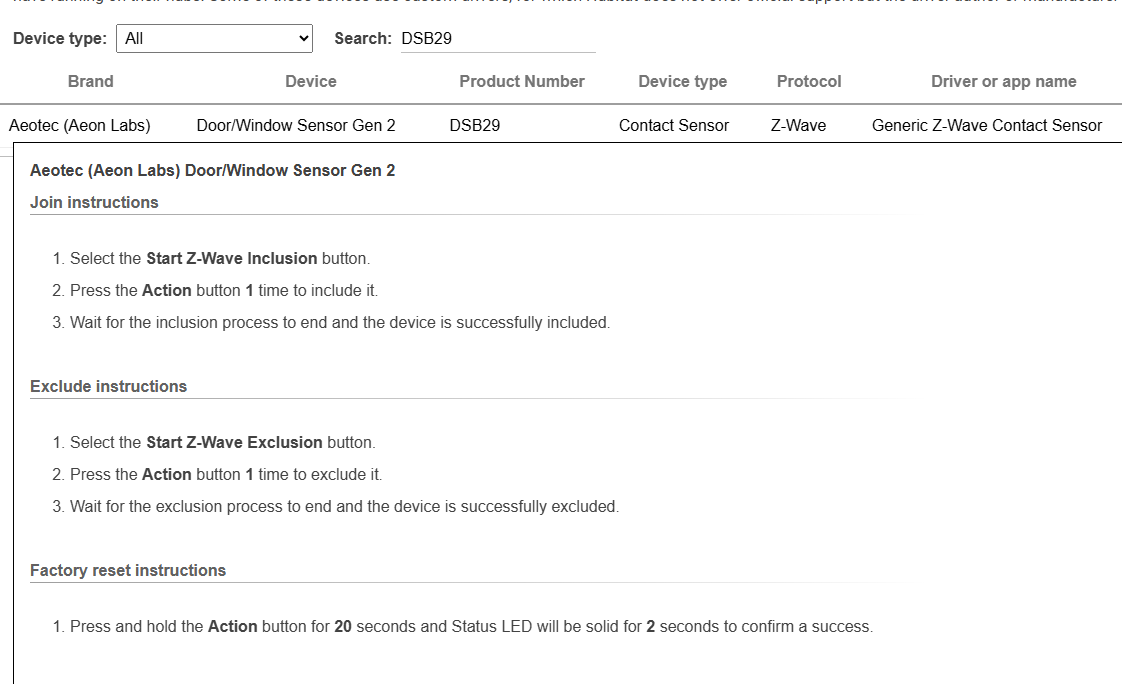

Also FYI from Compatibility list for DSB29

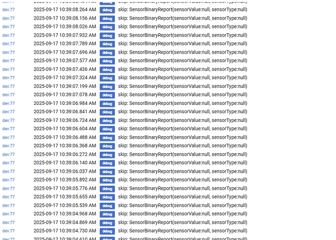

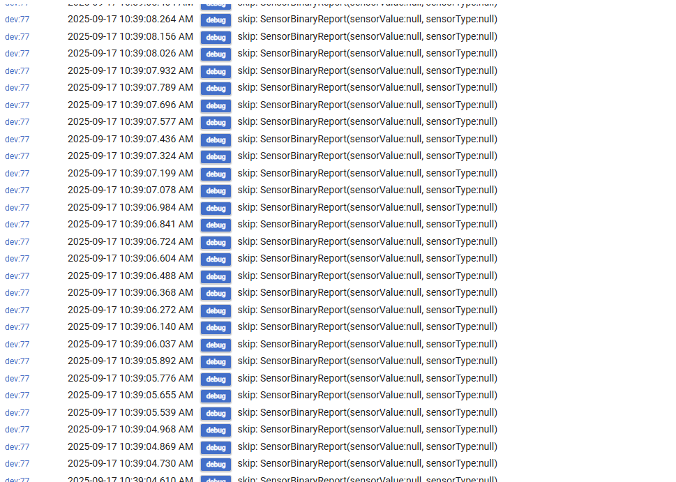

Full screenshot of device log , , , sorry so
long . . . I factory rest and re-exclusion/inclusion device this morning.
I also loaded the custom driver and ran the parameter at 121.
