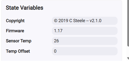

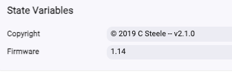

What firmware version for the device?

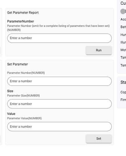

I made some manual changes to the parameters using the basic tool. Will see if it helps and will come back.
Big chunks of the basic tool were incorporated into the driver (with permission) if you didn’t realize. ![]()

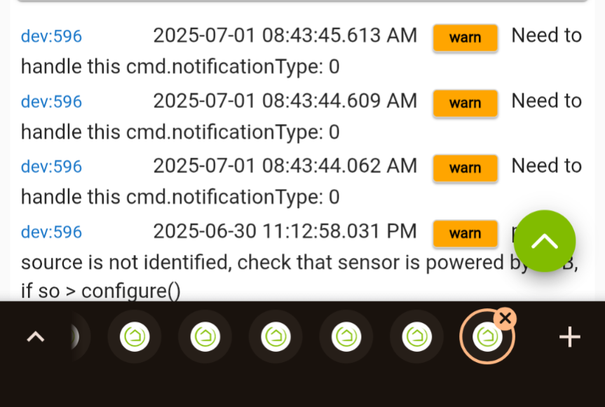

@csteele odd, was working fine, then last night I clicked configure on the device after I made some changes with you driver and it stopped working.
This morning I changed the lux change valve to 5 and pressed save and it's reporting again. (Have not clicked config)
@csteele are you seeing this in your logs for your sensors?
All of mine are and only since later hub update.
