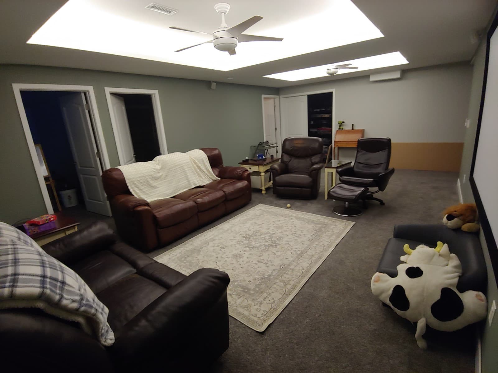

In my basement rec-room, there are two large areas with the ceiling recessed by about a foot compared to the rest of the ceiling. We have LED strips attached to the bottom ledges of these areas pointing upward, providing indirect lighting.
I currently have three types of LED strips (WW, CW, and RGB) attached to two Mi.Light controllers, run by two of their wall panels and a remote control, with the whole thing turned on and off with a Caseta switch. It's flexible (can make LOTS of different colors mixing whites with RGB) but that feature never gets used, and it control the two sides separately, a feature that does get used a lot. It's also overly complicated and can't be automated except to turn it on and off.

My new plan is to:
  • Replace the three types of strips with one strip of the new wide, high brightness type. (This project uses about 20 meters of the stuff.)
  • Replace the Mi.Light controllers with a single Zigbee controller that handles WW + CW balance.
  • Use WW for one area and CW for the other, so I can control them separately (like I can now) but only for brightness.
  • Use the color balance to control which side is lit - Cool white will turn on one side, Warm will turn on the other, and neutral will turn on both sides.
  • Ideally, use one of my Picos to control brightness and use its center-button to switch between “color modes”.
