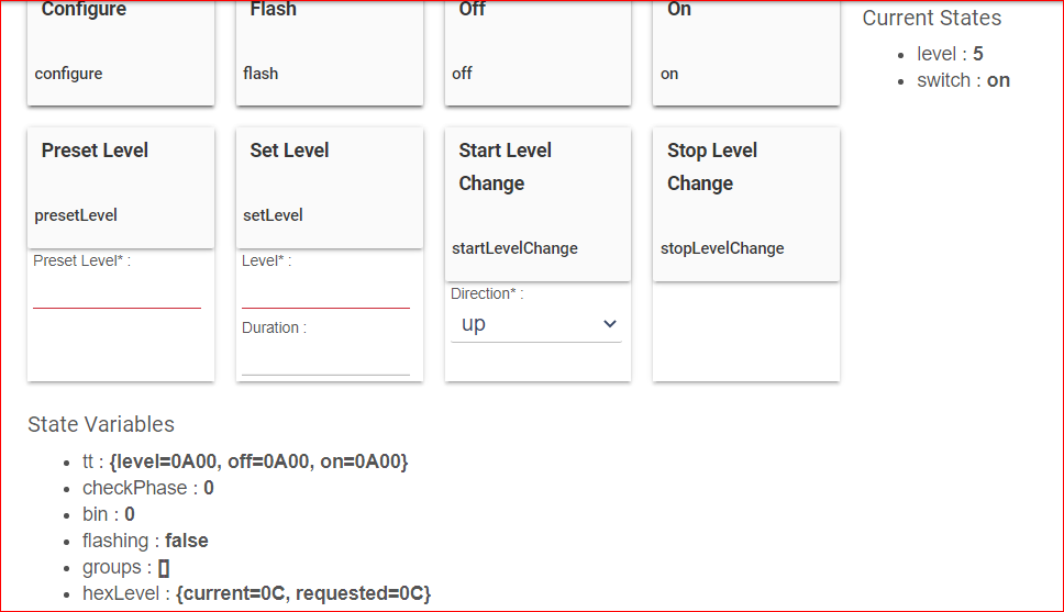

Advanced Zigbee Bulb driver: Set Levels 1 to 4 do not work
When entering Set Levels 1, 2, 3 and 4 into this driver, the Current State level remains at 5, and the State Variable hexLevel at 0C.
I'm sure there is a reason for this, but I would like to dim the bulb for use as a night light, and level 5 is too bright.
Bulb is a Sengled E11-G13

It's set at 5%. Did not notice that option, but it explains the 5% cutoff.
However, when set to "No Selection", then saved, it always sets the value to 5%.
It would be great if there was a 1% option. Would that be possible? @mike.maxwell
Also when level is set to 1%, the hex level should be 1. Then for numbers > 1, perhaps something like hexLevel rounded down = (level -1) x (255/99)
Hopefully the bulb hardware and firmware allow the actual output level to go lower than hex '0C'.
