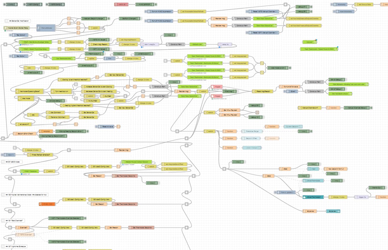

That's just it :wink:, we're very sensitive to the AC here in FL. I have a custom controller i built in NodeRed that let's me control the system the way I want to, down to a 0.1 of a degree. The logic is mostly sound and has been working for years. The only downside is the device shows the internal temp, and not the average zone temp. This is only superficial and not necessary to the function of my controller logic.
