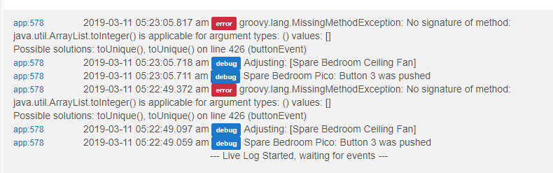

@stephack have you been busy improving this ABC over the ST version or what?! Awesome man. Got a quick question. Been setting up another Pico controller (5 button) and wanted to cycle through the 3 fan speeds on a GE Fan Switch (Dimmer style) just using button 3. I am getting this error so I am thinking I must not be understanding how to set up the action correctly in ABC. I thought that was what Cycle Speed (Legacy) did but I am getting this error.
I don't think the driver is the issue (it might be but I doubt it). I don't have a legacy zwave fan to test with...so I guess you are the first person in HE to try one with ABC. Welcome to the beta club
I also don't think you are using the latest version of my app but I haven't changed that section of code since I ported to HE.....I just don't have the exact line numbers to give you.
Try this...in the adjustFan() method, a couple lines above at line 428 there should a a line that reads def currentLevel = device.currentLevel
Change that line to def currentLevel = device.currentLevel.toInteger()
If that fixes it, I will update the app sometime this week and include that change.

Ok, I found the issue by looking at my other methods. I never updated this section to match the others. Replace the entire adjust fan method() with the following:
