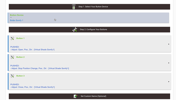

Our objective: Create a Legacy Shade (controlled 100% via HTTP post).
1- We created a Virtual Button (Button A), with 3 push.
2- We created a Virtual Shade (Virtual Shade A)
3-
a)We created a child in ABC, "Somfy Showroom"
Inside the Child we have the Virtual Button (Button A), and it refreshes with the 3 buttons automatically. Great.
b) Setup of each button inside ABC, to work with the Virtual Shade A. One button for open, one for stop, and one for close. All Associated with the Virtual Shade A.
4- We have 3 rules in RM:
a) When Virtual Button A, Button 1 pushed - send HTTP POST request for open
b) When Virtual Button A, Button 2 pushed - send HTTP POST request for stop
c) When Virtual Button A, Button 3 pushed - send HTTP POST request for close
(The rules if triggered manually, they work OK, and shade opens/closes/stops via http post in the rules)
Now comes the doubt.
How do we add to the dashboard, and which template to use to have the window shade show with 3 buttons (up/stop/close).
We tried adding the virtual button A, as a template Button, but only shows 1 button and each in different tiles.
We tried the Shades, but the scroller doesnt work either. The same with Garage, or Garage control.
If someone could point me in the right direction I would really appreciate.

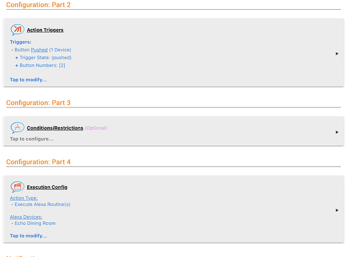

Is it possible to use Hubitat's virtual buttons in ABC?
Here is my use case:
I have a few BlueAir Wifi Air Purifiers. I can connect them to Alexa/Echo to control them. I have configured Echo speaks to execute a routine on my echo device. I then have created a virtual button to trigger the echo speaks execution.
Virtual Button 1 triggers the routing on the echo to set all fans to high
Virtual button 2 triggers the routing on the echo to set all fans to off
Now, I am trying to configure a Lutron pico with those virtual buttons.
Press button 1 on the Lutron pico, trigger Virtual button 1 push which launches route 1 on echo speaks, fans on high.
Press button 2 on the Lutron pico, trigger Virtual button 2 push which launches route 2 on echo speaks, fans to off.
I'd prefer a virtual button in ABC for this as it would be a single device vs multiple virtual switches.
Am I thinking this too complicated?

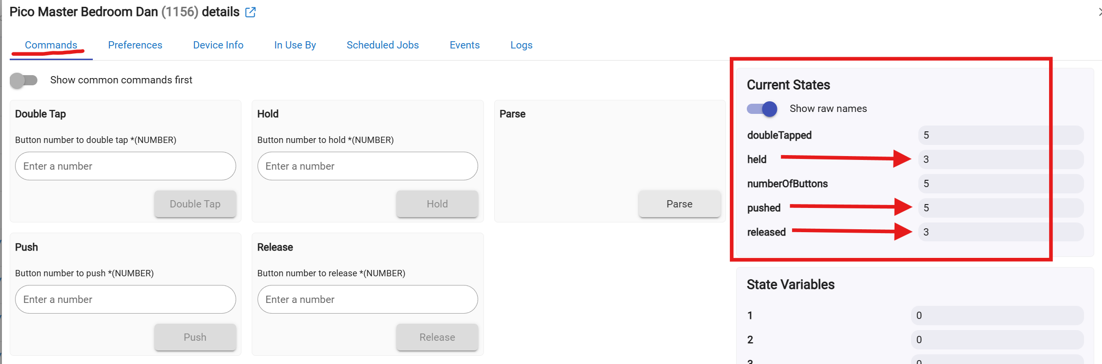

What specific model number is this Moes scene controller?

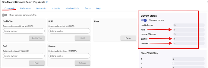

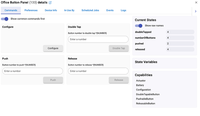

For now, let's ignore the ABC app, and focus our attention on the Moes Scene controller device in Hubitat. Please open that device's page in the Hubitat web user interface. Once you have that page open, please press each button on the Moes scene controller and observe the Current States section of the device's page as shown below.
Note: The above is for a Lutron Pico remote, so your screen will look a little different.
Each time you PUSH a different button, the number next to the "pushed" attribute should change. Please verify that all 4 button numbers appear as expected.
Each time you HOLD a different button, the number next to the "held" attribute should change. Please verify that all 4 button numbers appear as expected.
When a button is RELEASED, its numeric value should appear next to the "released" attribute.
PLEASE NOTE: Not all devices support pushed, held, and released for all (or any) buttons. Much depends on the specific device and the driver that that is being used.
By determining how your Moes Scene Controller behaves, it will greatly help in understanding whether or not each button can be used as you intend.

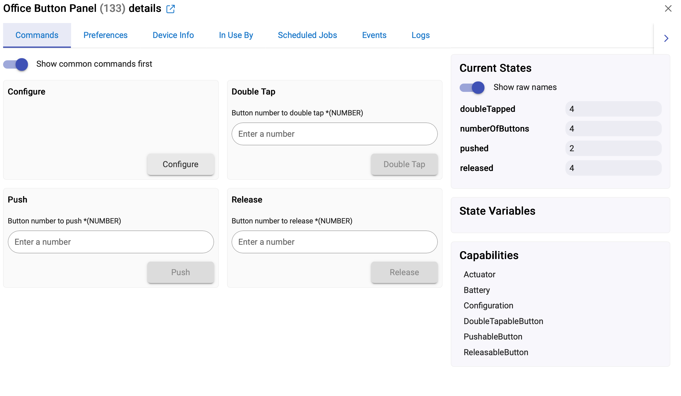

All are behaving as intended.

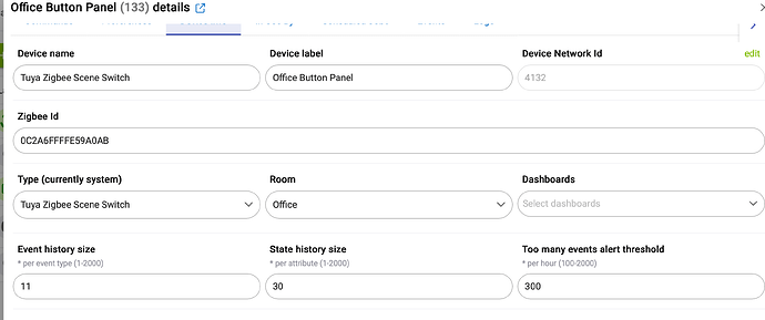

  1. Please share a screenshot for the Moes device like the one I shared above.
  2. Please share the model number of the Moes device as reported in the Hubitat device page.
  3. Please share the name of the driver being used by the Moes device.

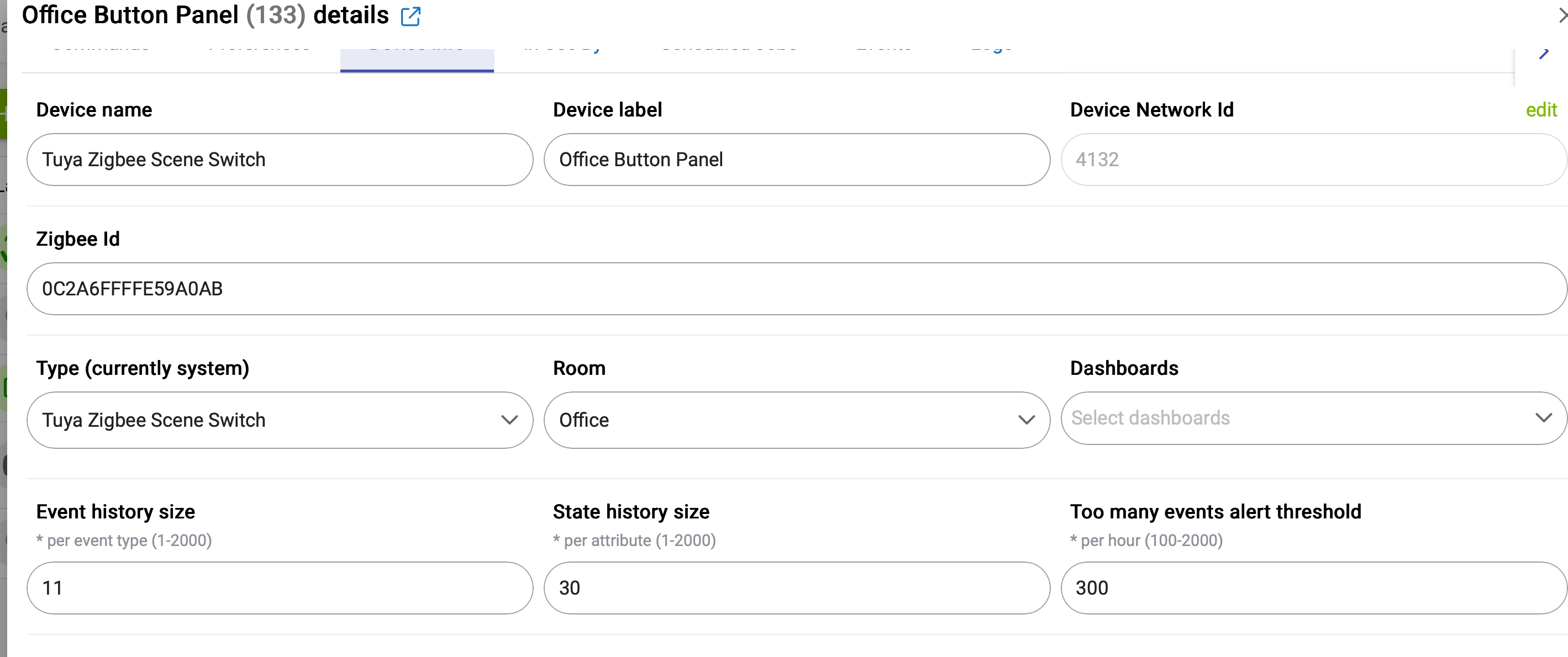

Sure. The back of the device says: Moes Wireless Scene Switch 24/45, Model ESW-0ZAA-EU
It appears that particular device/driver combination does not support “held” events per the Hubitat standard definition.
Your screenshot is also odd that the pushed button number and the released button number are not the same. Typically one presses and release a button, causing the pushed and released values to change to the same button number. Pressing a different button will cause the number to change for the pushed and released attributes.
