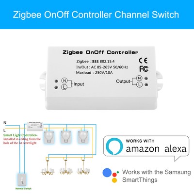

Hey All,
I bought one of these zigbee repeaters to add to my hue bridge/network. How do I pair it with the bridge ? Is it paired as a light or accessory cause all the accessories are listed as branded devices.
This is the repeater

I have this repeater in pairing mode (I think, the paperwork says if the red lights blinking it can be paired, if theres no red light hit the reset 5 times, with 3 seconds between reset presses lol). Did that, less than 5mm away from the hue bridge and it wont show up as a bulb.
Did it as an accessories and clicked a bunch of the branded switches etc in the "accessories" tab til it did a general search and can't get it to show up there either.

That repeater uses ZHA. Hue Bridge is ZLL. It will not pair to the Hue Bridge.
thanks @Ryan780 - saved me throwing more coins in the swear jar.
Will add this to HE so its not wasted. Re-read my experiences thread and I must of misunderstood what I was told, which is often the case.

Sorry which driver do i use as there isnt one for Generic Zigbee Repeater @mike.maxwell
If it is paired, and you just want to use it as a repeater, it doesn't matter what the driver is. But i believe if you want to actually use it, you would use this driver:
thanks ryan, nah - not interest in it controlling anything.
