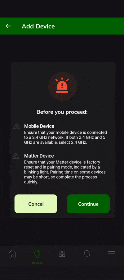

I tried to add Matter device (Sonoff Mini-D) directly to Hubitat C-7.
It says added successfully but gets stuck at "Pairing Matter device, current stage: searching for device."
I am using latest version of Hubitat and the Hubitat android app.
Wifi 2.4GHz.
How can I debug what is missing/wrong?
screen-20250929-1129462

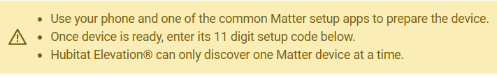

I think it is not intended to pair a matter device directly to HE, so maybe try to follow these instructions, worked fine for me so far:
I don't have another Matter controller.
Docs say:
Hubitat Elevation is a Matter controller . This means you can pair devices that support Matter to your hub.
You can pair a matter device directly to Hubitat.
You don't need another one...
