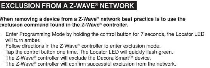

I recently removed reset and rejoined a dimmer module. I used the below to exclude it:
