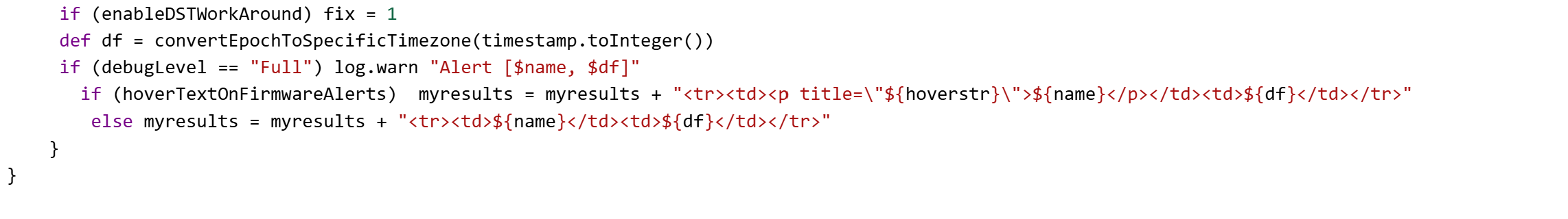

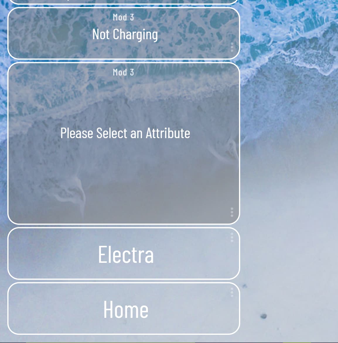

Adding hover text to attribute table (too.long) attr doesn't ahow
adding this breaks the atrribute display on the legacy dashboard:
 if (hoverTextOnFirmwareAlerts)  myresults = myresults + "<tr><td><p title=\"${hoverstr}\">${name}</p></td><td>${df}</td></tr>"
            else myresults = myresults + "<tr><td>${name}</td><td>${df}</td></tr>"
this works without the paragraph with title..
i have to post it as a image as the html doesnt show here
any ideas thanks

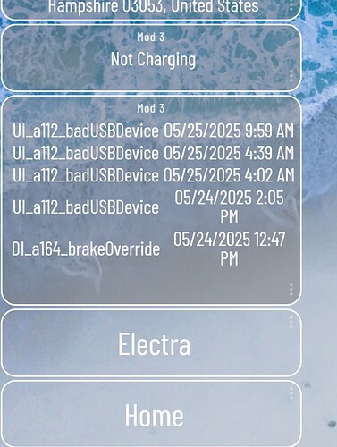

both work fine on the device panel and the hover text is working there.

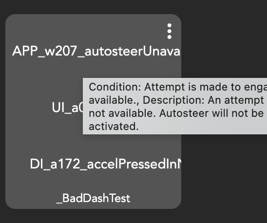

I'm not able to reproduce with a Virtual Omnisensor and the variable attribute set to this:
<table><tr><td><p title="test text">My paragraph</p></td></tr></table>
Demonstration of a tile with the variable attribute set as the attribute for an Attribute tile template:
Screenshot 2025-05-26 at 12.15.30
I would suggest paring your code down to a minimal example so you can figure out exactly what the problem is in your case, as the title attribute does not seem to be broken or problematic in general.

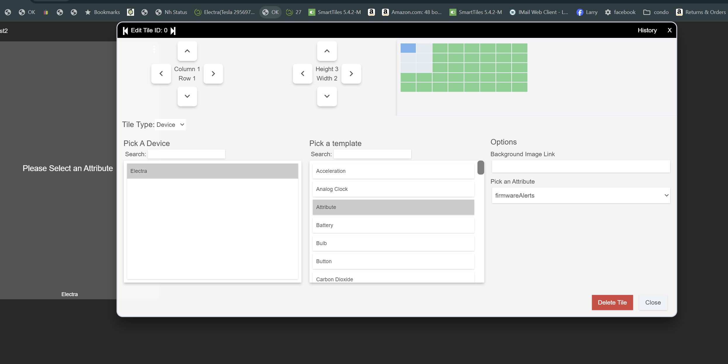

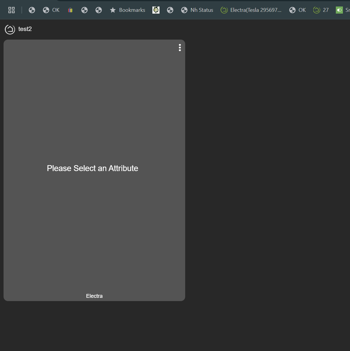

here is my just a regular dashboard
not a variable a custom attribute. not sure if that makes a difference,

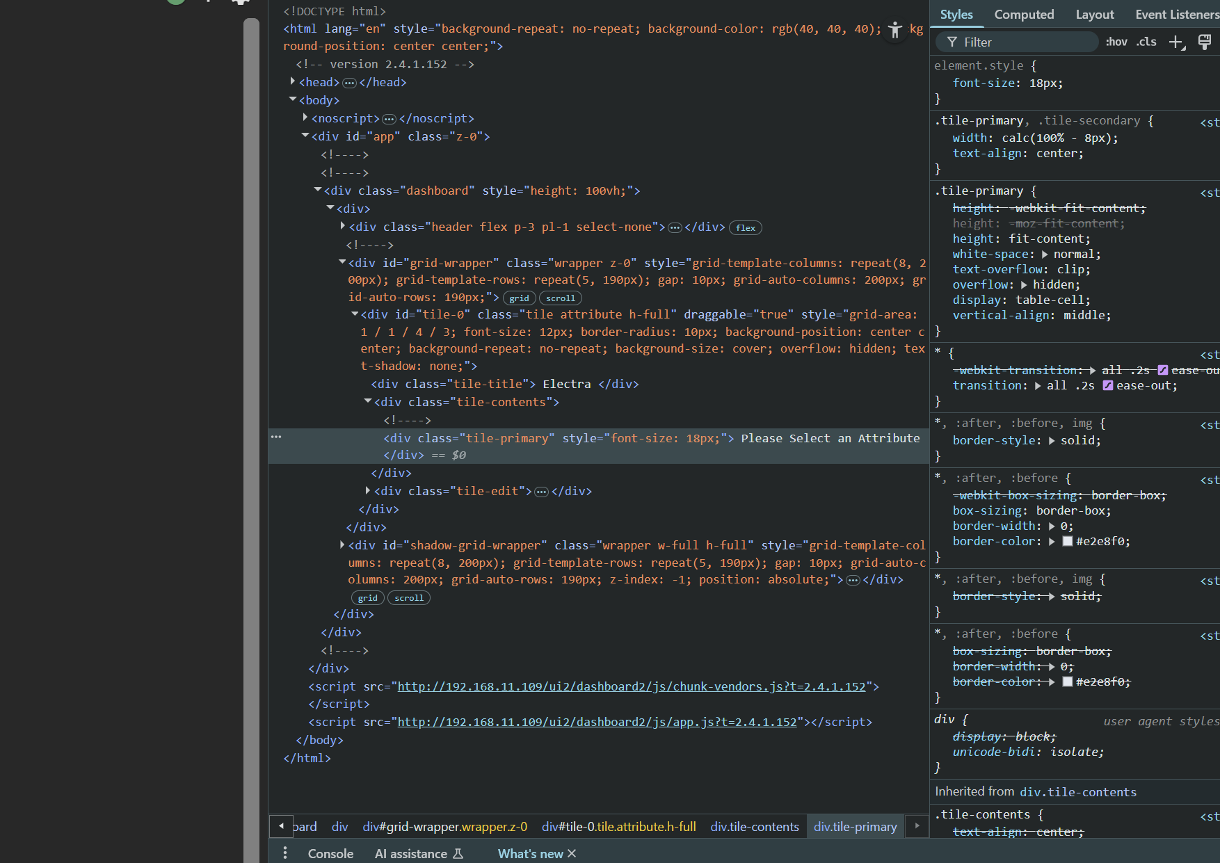

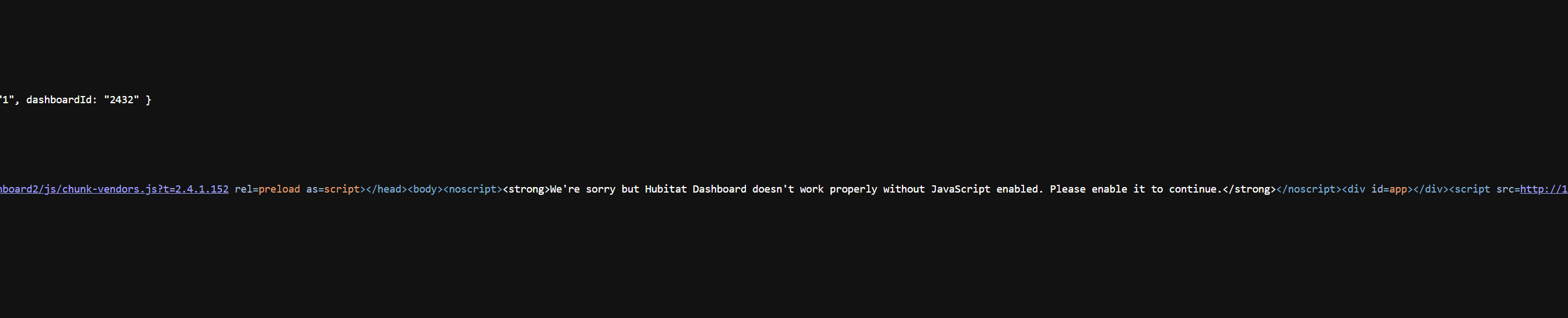

all i get is this.. when i look at source
thats not relavant as it sppears in a dashboartd that works as well
that was in chrome.. just tested in explorer same issue

it is minbimum.. its one table one attribute.. how do i actually see the page source,..,

there is not much i can do .. its obviously not renedering correctly some issue inside hubitat the source does not show the attribute..
any other attribute works.
