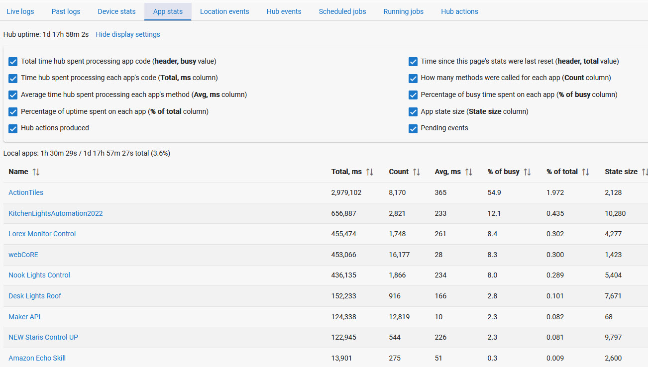

When you mentioned "high percent of total" where do you find that value? here is a pic of my app stats and it looks that action tiles are taking most of it (but again it could be normal)

It's the "% of total" column you see in the screenshot you provided. I don't use ActionTiles much anymore, but it being kind of high might be normal if you have lots of devices--it probably subscribes to all events (thus waking the app whenever anything happens, running its code) so it can always update the dashboard. If you aren't noticing any problems, I wouldn't be worried.
